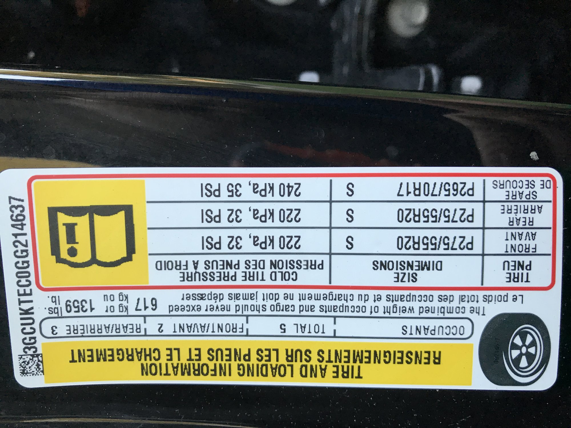

Should say somewhere on the driver side door jam if I’m not mistaken

This!  Just don't exceed your gvwr on public property.  You could probably put 1T back there if it's just you and the wood.

This thing says 1359 lbs, sorry for orientation of pic, seems very low to me, is that the number?

There’s another sticker somewhere there with VIN and date of manufacture

To do this “right” IMO you would need to fill the tank and scale the truck with you in it then subtract that number from payload to be all legal like. Of course who knows how much the wood weighs anyway...
1359 is a bit low, my truck says 1450 and is optioned similarly.  I’ve hauled a ton of wood pellets plus a passenger.  My truck handles it fine.
At the same time, if yours doesn’t, I’m not responsible for you knowingly going over the limits.
