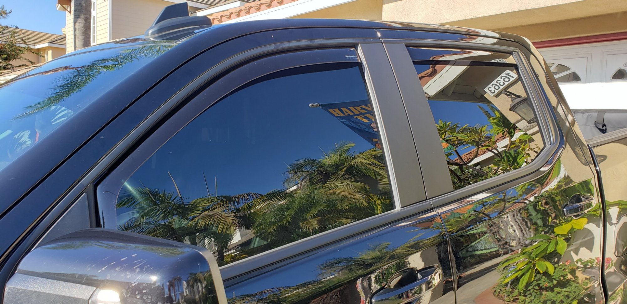

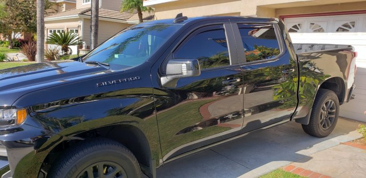

Hi everybody. I am in need of some quick help.. I'm installing the weather tech window deflectors right now and I can't get my window to go up all the way. It has a safety feature that kicks in. I have tried the steps to reset the window but that isn't working. Anyone who has installed these with this issue with a fix. Please let me know asap! Thanks!
When raising the window do not pull the button all the way up. There are 2 stages, half up keeps raising until you release and full up is auto raise which has the safety mechanism causing it to back off.

Thanks for the help, I was actually doing that but it was still going down but I realized the trick was I wasn't pulling gently outward as I rolled up the windows. Got them all up and it's looking great! Overall super easy minus the little hiccup..
