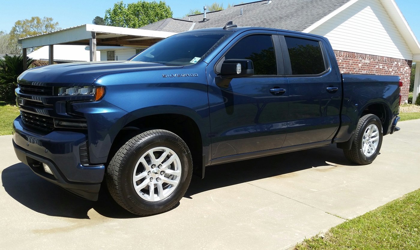

20% tint on front doors and 35% over rear factory privacy glass, short copper coil antenna (no reception loss) and 2" rear drop shackles (sits level now).  22" tires and wheels next.

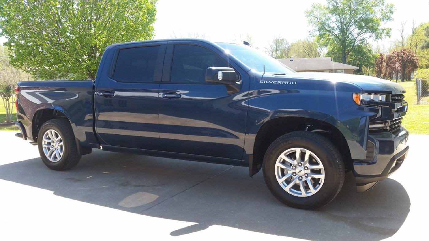

Got the leveling kit and rear block installed a couple weeks ago. Got the 33x12.5x22 Toyo’s put on this week. No rubbing!!! Very happy with this setup.342258BE-0991-4D7B-814D-2646843A64EE.thumb.jpeg.774cc6a3b2b7181a7b75852b572df837.jpeg8EF2E3CF-C5BE-4630-8DA8-D31EA47DD3C4.thumb.jpeg.577d6ec165e6321f84ebbdb8693a7158.jpeg

What size rear block did you get and where from?  Which leveling kit?

Leveling kit is from Rough County. The rear blocks and u-bolts are leftover parts from my 2016 Sierra. I kept all of the stock parts when I installed a 6 inch lift in that truck. I was going to buy a 1” block kit from ready lift but had these lying around. The 2” leveling kit put the front higher then the rear and I need some rake for towing and hauling.

That's the look I'm going for with my Denali. Did you have any issues with the magnaride in the rear with the blocks?

No issues at all. The Rough County kit has relocation brackets for the front and the rear sensor bracket never moves as it is mounted to the top of the leaf spring.
