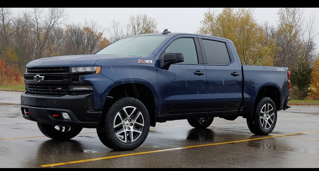

No worries. And here is a pic, I swear it looks levelf8f5028dcf412a848c993312741b0345.jpg

I dont think mine sits unlevel either but I think another an inch or 2 couldn't hurt!
