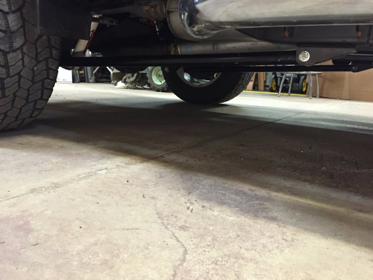

Lakewood Traction Bars on a 2014-2018 1500
I built these for my ‘08 and kept them for my ‘16. They have poly bushings at the frame end and 3/4” rod ends at the axle. The rod ends are Teflon lined and they are still quiet and tight.
