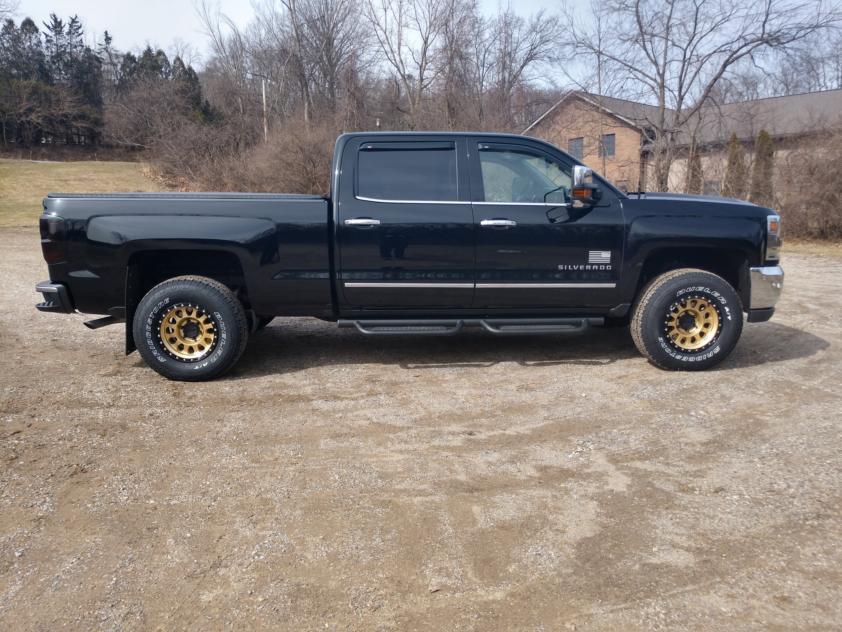

wepiii Posted March 11, 2019 Posted March 11, 2019 So I got a 2.5” leveling kit put on my 18 GMC Z71 and the front is still about .75” - 1” lower than the rear... Anyone else have this issue? Any options? Sent from my iPhone using TapatalkGot a picture? I have a 1.5 inch level and mine is an inch difference Sent from my iPhone using Tapatalk
vhreso Posted March 11, 2019 Posted March 11, 2019 I have a 2" level. To the eye it looks pretty level, sometimes it even looks a bit nose high. When i measure it im about an inch or so lower in the front.

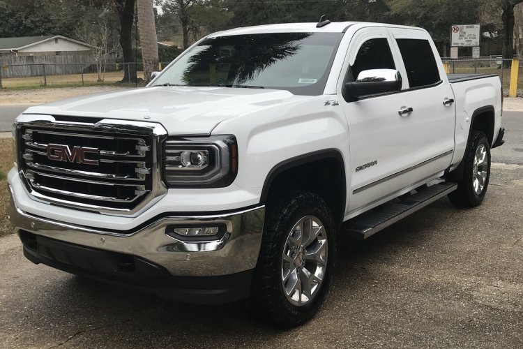

SS502 Posted March 11, 2019 Posted March 11, 2019 I have a 2.25 and my measurements are 39.5 from ground to high point on wheel well lip (black trim piece directly above the tire in line with center cap) front and 39.5 on the rear. That’s level in my book.

SS502 Posted March 11, 2019 Posted March 11, 2019 1 minute ago, aseibel said: keep the gas tank full to balance it out. But seriously, do you have any heavy tools/ gear in the truck or bed? I wouldn't worry about 3/4" difference. Unless it was nose high. So I would say you are in a good position. If it matters my picture and measurements are with a full tank of gasoline and a Bak flip 4 cover.

Kubs Posted March 19, 2019 Posted March 19, 2019 I have to actually measure the fenders, but I had originally lifted the front with Bilstein 5100 shocks on the max setting. This is supposed to be 1.86" of lift but it still had abit of rake to it. I installed 0.25" thick spacers under the bottom shock mount for another 0.5" of lift and it looks pretty level now. Maybe 1/2-3/4" of rake max.
