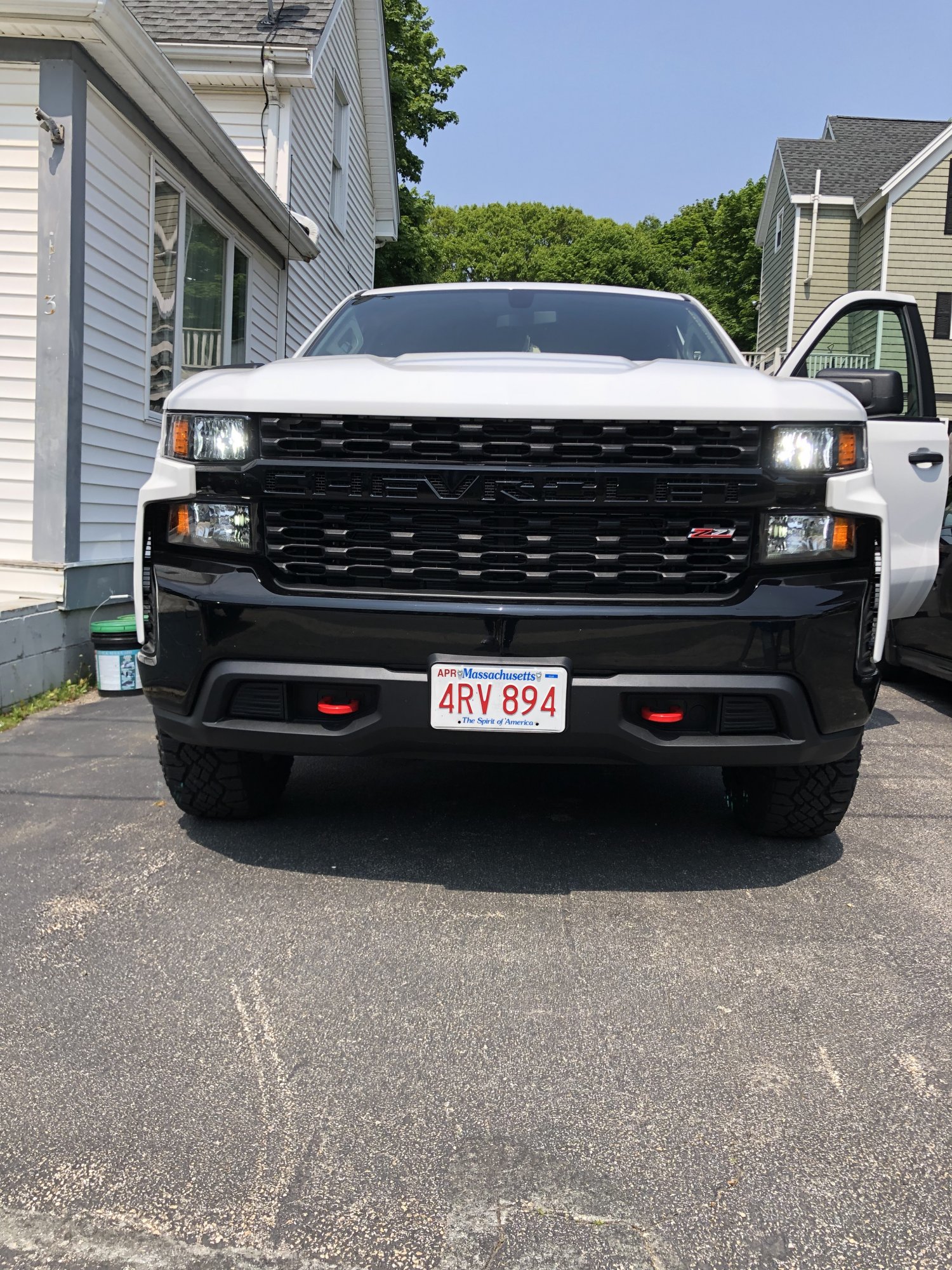

Just installed mine as well. 100% recommend but damn gm doesn’t make it easy to get your hands in there lol
Nice!! ????
I'm glad everything went as planned. Looks good!!
And your right. GM didn't leave much room down inside the fender for even a medium sized hand, but persistence pays off. ?
Was going to take a better picture when it gets dark but of course it starts down pouring
