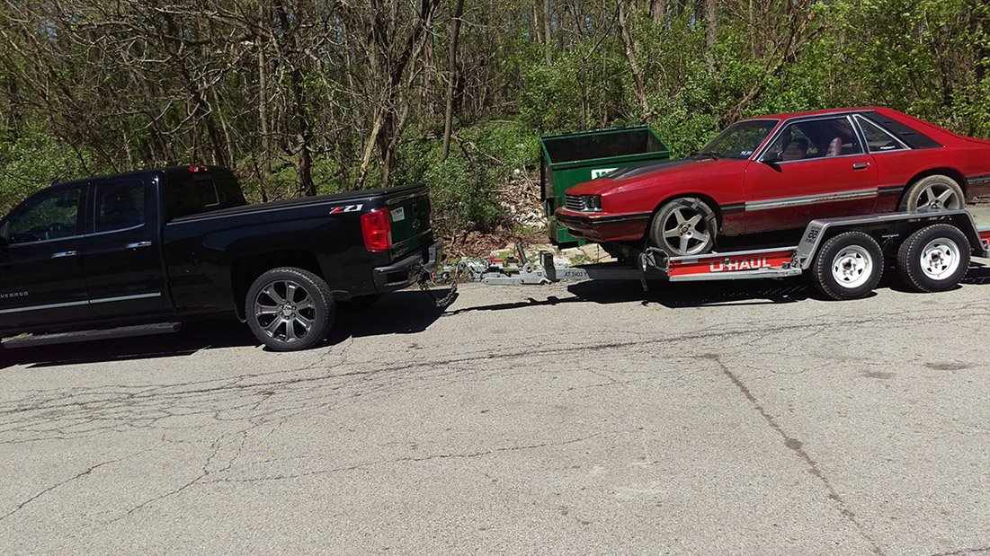

On 4/25/2019 at 9:55 PM, EDL said:
The trailer is 2230ish lbs and the curb weight on the car (per spec) is a little over 2600lbs.  I'm gonna be safe and say 5,000lbs total for trailer and car.  With that weight, that means I'm looking at a tongue weight of around 750 to 800lbs.
Going back to what you thought you were towing, your more than fine, I think you might be heavy on that quoted tounge weight but you over estimated which is the better way to go.
You got this covered......IMO your in the weeds going over way too many #'s, pick a decent drop value for your ball mount, or maybe they even rent them at Uhaul with tthe trailer, IDK, hook up the trailer, load it, strap it down and, get home and get wrenching....
Sounds like you wont be pulling much or often so try not to overspend on some super fancy set up.
Happy motoring...?
Our trucks have class IV hitches. They are NOT weight distribution hitches. They are quite strong, rated for more than our 1500s will pull. They are designed and used, so that they will not be the weak link in this application.
That damn V-5 on the sticker plus 12k rating made me think I had a class 5 without measuring.  I ended up getting a 2.5" version of the really nice B&W tow and stow adjustable drop hitch.  Fortunately, I scored such a good deal I sold it for a profit.

Yeah, I'm good, looked at the placard under the hitch as someone pointed out, same exact one, hitch is rated to 12,000lbs and 1200lbs tongue.  The double cab 4x4 with 6.2L I have is rated to haul up to 9100lbs as per GM, so I'm good there.
Only thing was finding a ball mount for the weight.  The only thing I could find at a local store was a solid shank 3-ball mount.  The 2" ball (which the trailer uses per u-haul) is rated to 10,000lbs and 1,000lbs on the tongue, so it's all good there.  The only thing is, it's a straight shank, no drop.  I hope that doesn't jack the front of the trailer too high.  Where I have to take the car from, the apartment parking lot is down hill onto the main road, I hope the rear end of the trailer doesn't drag getting out of the parking lot....but, about to hit the road right now, so I'll find out in a couple hours....
OK, car hauled home.  Easy peasy.  I am quite impressed with that 6.2L.  It hardly struggled, even up the hills here in PA (I think it kicked down once or twice and revved to about 3,000 RPM to pull a couple hills at 55MPH, most of the time it'd just drop a gear and hit 2200-2400 RPM).  I played with tow/haul mode, but honestly, didn't even really need it.  I filled up with gas before heading home and filled up when I got back, 15.2MPG for the 2.5 hour drive which was mostly 2-lane, 55MPH, some 35-40 MPH through some towns and a jaunt on I-80 where I cruised around 65.  Not going to complain with that.  And as far as the straight shank hitch, once we got the car on the trailer, it set just about perfectly level.
Now, after this, two things I would definitely change on the truck if I were going to haul 5,000ish pounds for a longer distance.  I would probably put one of those Roadmaster "Active suspension" leaf spring assists on it and I would consider better rotors and pads for the brakes.  The rear suspension was a tad squishy and every bump felt like it was coming through the bed of the truck.  Brakes were adequate, but downhill braking I was wishing for a little more pedal.  Then again, that u-haul trailer didn't have electronic brakes, it had that weight shift set up on the tongue that's supposed to apply brakes to the trailer as the weight shifts forward under braking, but I can't honestly say if they were working or not, or just out of adjustment.  All in all though, I won't complain too loudly.  Even without the max tow package, this thing is quite capable.
Attached is a photo of the setup (as much as I could fit in the picture) after got the car onto the trailer.
Good to hear it worked out,
Great looking truck by the way, looks just like the 16 I had!!!!
