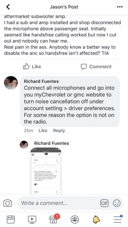

I had my sub and amp installed last week and the shop unplugged both microphones in the headliner, I went back as soon as I noticed hands free wasn’t working anymore and had him reconnect the one above drivers seat. Seemed to work again but now it’s cutting in and out and people can’t hear me on my phone.
Anybody know now what needs to be done differently maybe to disable the active noise cancellation of the Bose setup?

Anyone else not able to get into “driver preferences” on the website? It’s greyed out, and I’ve now spoken to two different customer service reps that say I can only adjust vehicle preferences from inside the vehicle. 2019 AT4
