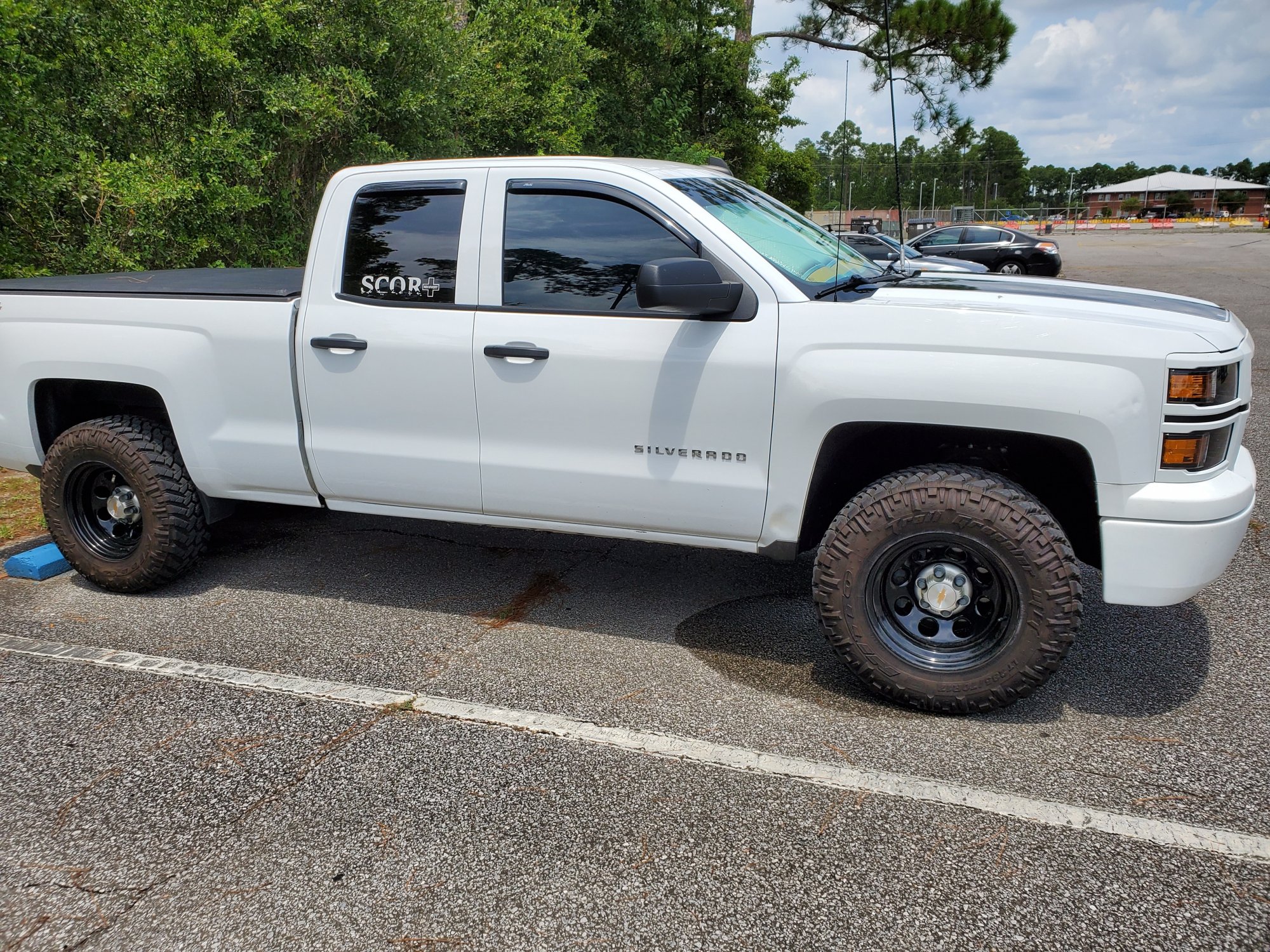

A few months after I bought my 2015 Silverado 4x4, I switched all of the stock shocks out with Bilstein 5100s.  I'm active duty and have access to the base auto hobby shop so I used their spring compressor for the front.  I put the front shocks on their highest setting to level out my truck.
Overall, I think it rides pretty great, but I've got nothing else to compare it to.  I've taken it everywhere from rock crawling in Southern California to the mud pits in Florida with no issues.  My only recommendations are to definitely have your front end aligned (the shop I bought the shocks from told me I wouldn't need it but I could see the off-camber wear) and fabricate some sway bar quick-disconnects.  Considering the truck is IFS, you don't get a whole lot more articulation from disconnecting the sway bar but it definitely does ride smoother on trails.  You could also just climb under and unbolt them before you head off road but that's a huge PITA compared to having to just pull a couple of cotter pins out.
I'm also riding on 17" Pro Comp Steel Wheels with 285/70R17 Nitto Trail Grappler M/Ts for reference.
Hope this helps.
