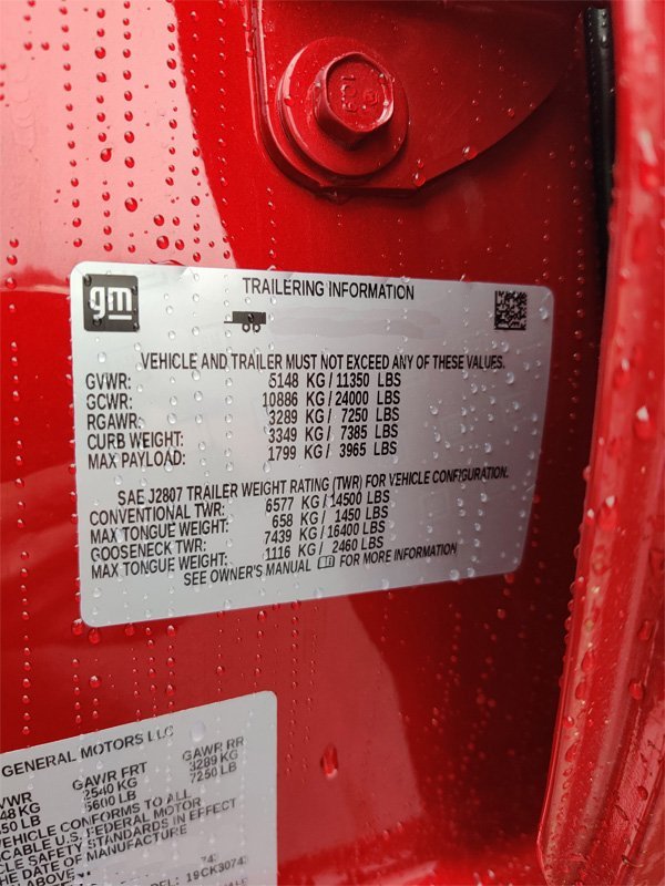

The 2021 2500HD  crew cab, standard bed, diesel has two different GVWR. 10k w/ 11,530 trailering and 11,350 GVWR w/ 18,500  trailering. I was told by a dealer that they are identical suspensions, frames, axels, gears etc. between the two and they actually could carry and pull the same load safely. The 10K GVWR  rating are manipulated to meet certain requirements.  True or false?
 I dont think this is entirely true. I think everything is the same except the tires. When I build mine I had wanted the 11350gvw and I had to get 18 inch tires to get that as the dealer said they could not get proper load rated tires in 20 inch rims. Not sure if that is true or not but it's what I was told. And everytime the dealer tried to add 20s it took the rating down to 10k gvw.
11,350 GVW is on crew cab standard cab models with diesel and 18 or 20 inch tires.  The GVW lowers with 17 inch tires.   For 10k GVW, option code CG0 is checked.  Your dealer does not know what they are doing.
#iworkforGM
#iworkforGM
Then gm software is mistaken to. He showed me everytime we put 20 inch rims on the truck it took away the 11350 GVW we tried several rim and tire combos. 18 inch rims was the only way the ordering software would allow us to keep the 11350 gvw. This was on a crew cab 2022 2500 diesel with a 6 foot bed.
I'll add to there is a lot of things you can spec online but whe. You actually go to order what you speced on the web GM won't actually build. The reason I was at the dealer was GM rejected my first build . My original spec was for a double cab 6 foot diesel the rejected because they were not building double cab diesels. I either had to get a gas engine or a crew cab. Which I'm glad happened. But I speced that truck on the gm website printed it out and brought it with me.
Edited by Adam9066
It must be mistaken, or there needs to be some combination with those wheels to get the GVWR. My crew cab AT4 with 20s is 11350 GVWR.
Definitely an issue with the build software on their website. I tried to build my same truck (2021) using the 2022 model year and every time I pick 20" wheels/tires it forces me to choose the lowered 10k gvwr. Follow those exact same steps when building a 2021 and asks you to chose between the lowered 10k gvwr and 11,350 gvwr.
11 hours ago, MTU Alum said:
There are no differences between the 10k and 11,350 GVW except the sticker on the door.
Might want to let gm know because like I said they would not or will not let  you spec 20 inch rims on the 2022 models year 2500 for a 11350 gvw truck. Not sure if that has changed.
By the way im not complaining it was not that big of a deal for me either way im actually happy with the 18s . I like the rims I got  they look good with the pacific blue. I wish I souls have optioned to black the truck out in the sle package but it looks good the way it is to.
Here's the door sticker on my 22 2500HD with Duramax and 20" rims. I never really cared about it and only went to a 2500HD because I hated the 10 speed transmission in my '19 1500. Now that I'm looking at adding a truck camper, it's become important.
  • Thanks 1
Amazing the difference a long bed diesel truck makes over a short bed Gas.  Compare your tow ratings to mine (3500 CC/SB 4x4 with Snow Plow / Camper option).  The way you spec'd your 2500 is awesome for towing.  Nice Job. :thumbs:
Edited by sheath
Add engine difference
I wish I could take credit for the build. One of the salesman at the dealer spec'd it for himself, then after the owner of the dealership found out, given no one was getting trucks at the time, they sold it to me. Needless to say the salesman was a little PO'd. I just wanted out of my '19 1500 and knew I needed to get into at least a 2500 to get away from that damn 10 speed they used in the 1/2 ton. Who knew at the time, I'd actually be kicking myself for not looking for a 3500 because I want to get a truck camper and I'm gonna be pushing the weight limits with my 2500.
BTW, mine's a standard bed, not a long bed.
Edited by GeneJock
I ran Firestone airbags on a 2500 Dodge, and it worked out awesome.  Not sure how that would translate to the Chevy, but always something to consider.
I figured long bed, since you're going to run a truck camper.  at 3,100lbs capacity with the short bed, you'll be close.  Salesman did a good job on the build.
