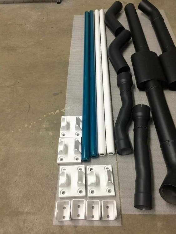

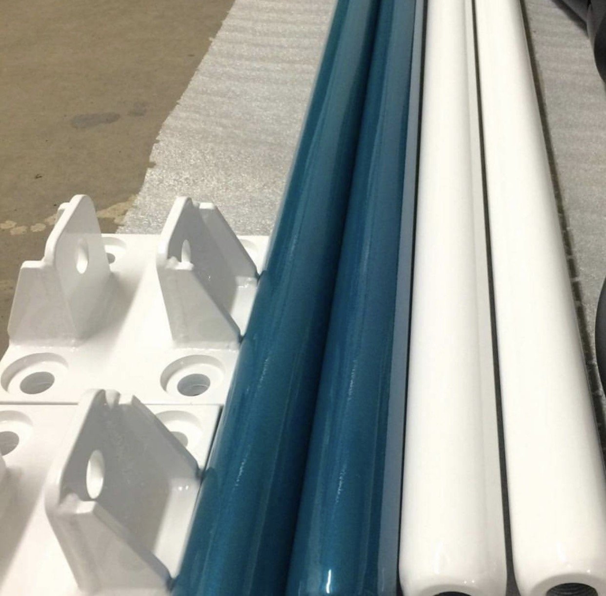

I made a set for my last truck 1.75" DOM, stainless heims with high misalignment spacers. Rear mount utilized the the stock ubolts (there was enough extra thread not being used). Front mount could either be welded on the frame, or bolted if you drilled one 1/2" hole. Been thinking about trying to design a set for this truck but wouldnt mind grabbing something off the shelf if it meets my expectations lol.

I had zero issues getting hung up on anything, they rear diff was quite a bit lower than the bars. That truck also did plenty of offroading at the sand dunes, cresting peaked hills. I do understand if youre worried about looks though.
