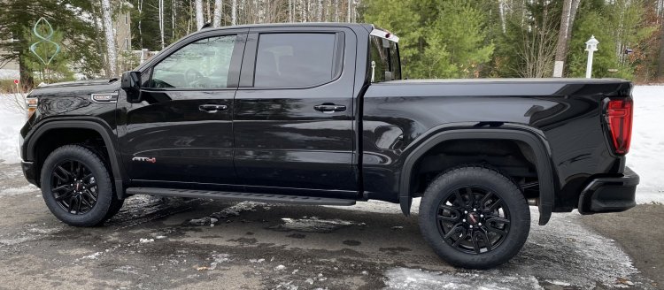

I have the 1.5” motofab lower strut spacer on my AT4 and the cv angles don’t look bad at all. They were pretty level with the GM factory lift (longer strut) which is probably why the 1.5” space did not change much. The UCA ball joints do not look bad either. I think ReadyLift offers a replacement upper control arm to correct the ball joint angles due to them offering a 2” leveling spacer instead. The CV angles however are not corrected. The 1.5” motofab Is netting essentially a cumulative 3.5” of lift but as opposed to running a 3” spacer on a not AT4/Trailboss the CV angles and balljoints are being stretched after the 2” factory lift while standing level at the factory lifted height. A non GM lifted truck with a 3” spacer is taking the angles stretch from the full 3” height modification. I hope this makes sense.

No, it doesn’t really make sense. Perhaps the geometry is slightly different making the angles a little bit better than previous models but the factory kit does not change the a-arms or drop the diff. It just adds longer cv shafts. So with that, you’re netting 3.5” of lift over a stock truck. I’d like to see what those angles look like.
