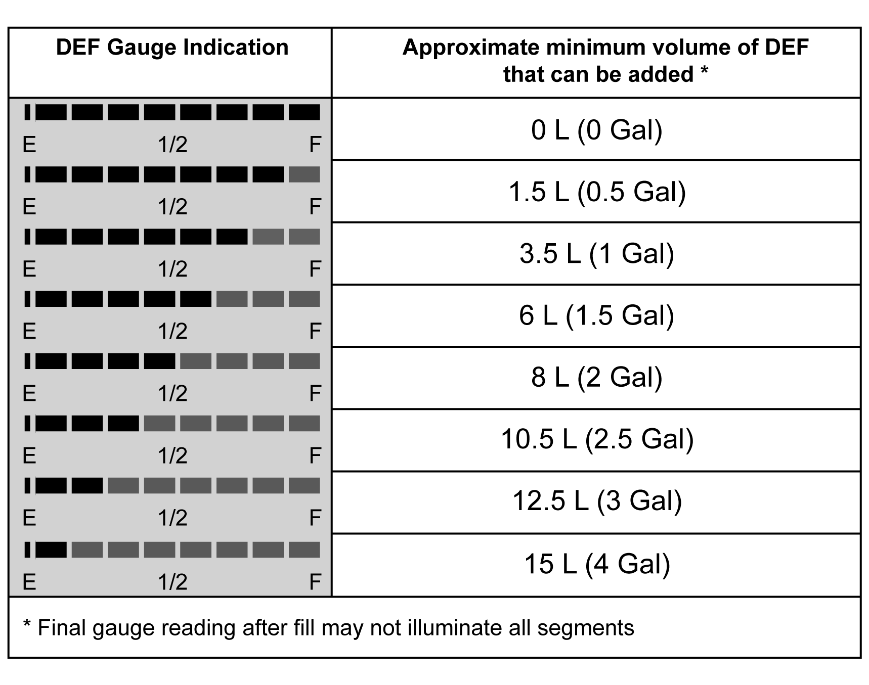

Having read complaints about the segmented level / range indicator and knowing that my dealer did not completely fill the tank, I topped it up at about 700 miles.
Since then 2 refills for a total of 11.27 gallons, covering 13,248 miles.
DEF mileage is 1175 mpg
Currently, life of truck fuel mileage for currently is 25.6.
DEF usage is a little over 2% of fuel.
On one of the fills, I ran it til it thought it was empty and gave the 'miles til speed limit' warning.
The 3.0L holds 5.3 gal. (L5P 6.6 holds 7.0)
For the 3.0, the segments on the 'full end of the level/range indicator are about 0.5 gal each.
At the lower end the last 2 full size segments are about 1 gal -- so 1/2 full occurs sometime when there are 2 segments light and before there is only one segment lit.
DEF consumption is related to fuel consumption (since more fuel burned means more NOx to be treated).
If fuel mileage doesn't change much the consumption shouldn't either.
The 'range' part of what it displays assumes that future mileage will reflect recent past mileage -- so if it's been towing, it's gonna figure the def range is lower.
IMO, the only good way to determine DEF mileage is the fill-drive-refill-calculate method.
This gauge just gives a rough idea about what it might hold.
