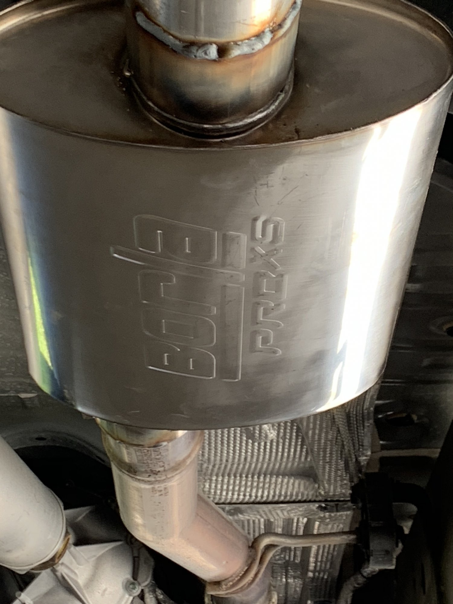

I just had a borla muffler swapped into my 2020 TB with the 5.3, I left the flapper to avoid any drone , which I had experienced with my 17 Sierra with the exact set up... well once it was installed my truck sounded just a notch louder above stock I was disappointed ... so I used some exhaust tape and covered all mess screens (resonators)  and wow it’s now sounds like expected ... quite off the pedal but nice deep growl on the pedal ...

Did leaving the flapper on with the ProXS eliminate drone? I removed the flapper and installed the Borla and the drone is awful. Extremely loud inside the cab.
I have the ProXS, flapper still on and all resonators covered with no drone at all.
