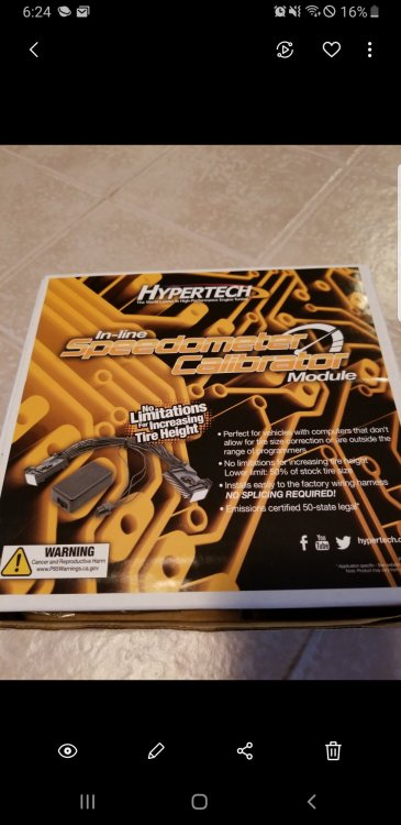

Honestly, I don't really know the specifics. But attached is the unit boxing and the instructions I found online pertaining to it.
I see the ones I bought were programmers, they did everything.
I use hypertext in my 05 silverado, plug it in, asks questions, runs  programs on truck computer and unplug when qued too.

That is exactly why Hypertech gives you a sticker/decal with their products.  The instructions suggest that you to put the sticker under the hood next to the GM emissions decal.  That tells a Service Tech, before they do anything, that the original programming has been modified.  Also tells a subsequent owner that the vehicle has been tuned in some way.  That is why the instructions also suggest that you remove any Hypertech modules/programming and revert back to the original state of tune before any in-depth dealer service diagnostics or related programming changes.
