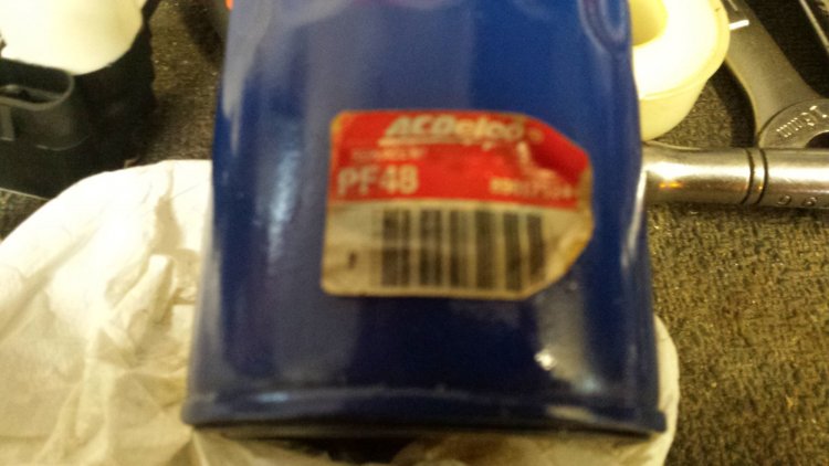

First oil change, i picked up a PF 61 E AC.DELCO oil filter, it doesnt fit. This is what its supposed to be. The filter i took off is a PF 48 E with a red label that ive never seen a red label before. The diameter of the threads on the PF 61 E is too small and will not screw on. I had a PF 48 E from my other truck which is an 09 GMC 6.0 and tried that. The PF 48 fits tightens and had no leaks. Only difference was the PF 48.E was a 1/4" shorter than the PF 48 E that I took off the truck. Any idea why ?  I would like to figure it out. I'm going to the dealer to have them decipher the vin. #. Does anybody have any idea why ? Thanks for your input. The picture attached is the filter I removed.
The red label filters are what come on the trucks from the assembly line when built. At least that is my understanding.
Correct.
Yeah, everyone's got you headed in the right direction. Personally, I use the PF63, that one extra inch makes all the difference......... yup, I went there.
PF48/PF48E and PF63/PF64 have different internal by-pass pressures.
Use the one that is recommended for your engine.

The PF64 and PF63 (Fig. 20) filters are commonly confused as an ACDelco PF48 and/or PF48E filter because both oil filters have the same appearance and oil can size. However, these oil filters are not the same and have different internal bypass valve opening pressure specifications. The PF48/PF48E has a pressure specification of 15 PSI (100 kPa) while the PF64/PF63E has a pressure specification of 22 PSI (150 kPa).

There is no documentation from GM that states the PF-48 supersedes to the PF-63.  PF-63 was put in use in 2011 on the LLT 3.6 High Feature V6 due to increased oil pressure and as a running improvement during the timing chain debacle on that engine.
PF-63 is not approved for the Gen 4 LS engines such as the 6.0.  Any flavor of PF-48 is fine however, from the old PF-48, the PF-48E and even the UPF-48R.  GM would have done away with the PF-48 if that was the case.
