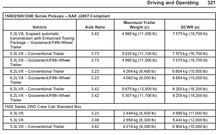

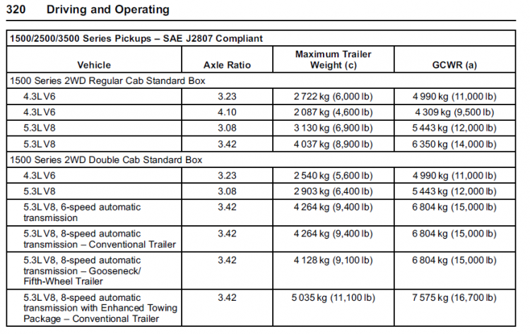

Have you looked in your owners manual? Mine is a '17 & it lists all the models with engine & gear ratio with towing & GCWR. Mine starts on page 320

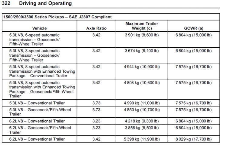

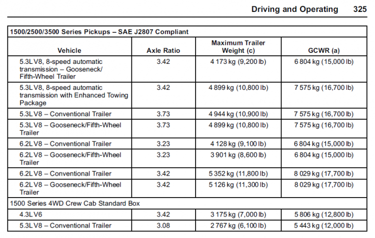

I somehow missed that, however I saw the 2017 here and I don't see the gcwr anywhere on it. I figured that since there was no change between 2016 and 2017 it would be the same but I couldn't find it in that guide.

I'm aware of the owners manual, but I somehow missed it when I was looking at it this morning. Perhaps it was too early and my coffee hadn't kicked in, but I'm seeing it in the digital version now.
Yeah, I hadn't seen it this morning but apparently I'm just thick. Thanks!
