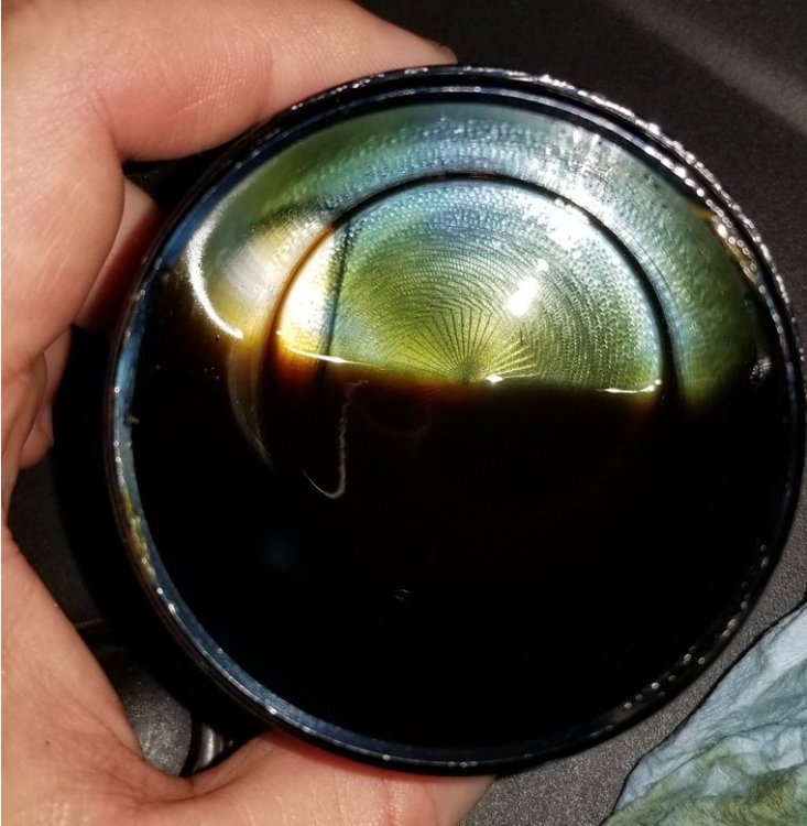

I've read quite a few articles on the pros and cons of oil catch cans.  Some say you need them on DI (direct injected) engines (to help keep the intake valves from getting carbon buildup), others say you don't.  So I did a little experiment on my 2018 Silverado L83 to see what would happen.
I mounted 2 separate catch cans - one connected directly to both crankcase breather lines that come off of the valve covers with an open element breather filter on the catch can itself (plugged ports on air box the factory crankcase breather lines attached to).  The other catch can is in-line of the PCV vacuum line.
I drove the truck for 500 miles, mixed city/highway.  The results were:
Crankcase breather catch can was bone dry - not even a haze of oil film on the inside of the can.
PCV catch can was a different story:
There's probably 2 tablespoons of oil in there after 500 miles.  I'm running Mobil1 0w20 full synthetic, engine has about 25,000 miles on it.
Based on these test results, I think I can remove the crankcase breather catch can but I'm definitely keeping the PCV catch can.

""2 separate catch cans - one connected directly to both crankcase breather lines that come off of the valve covers with an open element breather filter on the catch can itself (plugged ports on air box the factory crankcase breather lines attached to).  The other catch can is in-line of the PCV vacuum line.""
Seems to me, looking at the air/vapor flow passing from/through each catch can, there would be nothing collected in the vented can connected to the crankcase breather lines running to the valve covers, since the factory lines came from the air box after passing through the factory air filter element.   The open element breather filter now provides this air to the crankcase. Remaining clean and dry would be a normal condition one would expect.  The catch can in the PCV line is doing an excellent job, as it should.
