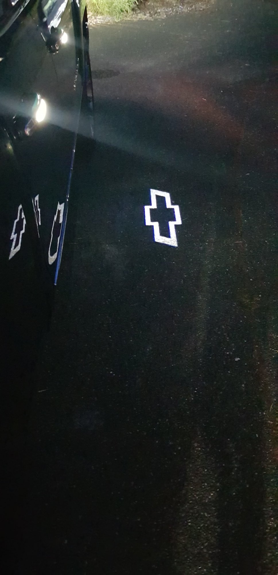

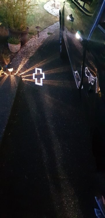

I haven't put them in yet, but I notice, per paperwork, the two colors for Chevrolet are Purple(DD) and Orange(PD).. but I got Purple and Yellow(unless I'm color blind), so I hope it's not a Chevy on one side and a Cadi on the other.. ??
**Update, they are both Chevy Logo.. :D **Second set of pic are after I notched the lamp insert so I can straighten them.
**Straighten to line up with body

Nice! Can you see how they are not perfectly aligned on the ground?
Yessir, and I actually don’t mind it. They angle out toward the front. So it actually looks ok to me. I did have to notch the forward edge of the hole in the mirrors as it’s not a direct fit with the K2’s even w/o messing with the alignment. On the old puddle lights there is a snap tab that’s just a fin on the new one. So I cut a tiny spot to make room for the fin and it snapped in flush. Apologies I didn’t take pics of the old/new side by side before I put them in. [emoji2359]
A fellow fb member actually fixed the angle problem with a little dremel and sanding, I haven’t done it to mine but it’s fixable.48097a63221d1f3a3d1f6f2623e3e096.jpg

I just notched it where it clips and I shaved off an angle on the top so it didn't push up against me motor housing inside the mirror.
Shaved off a little on the corner that was running against the inside housing. I went along the whole top side corner.
Notch towards the front since you'll need to turn towards the front to make it straight.
