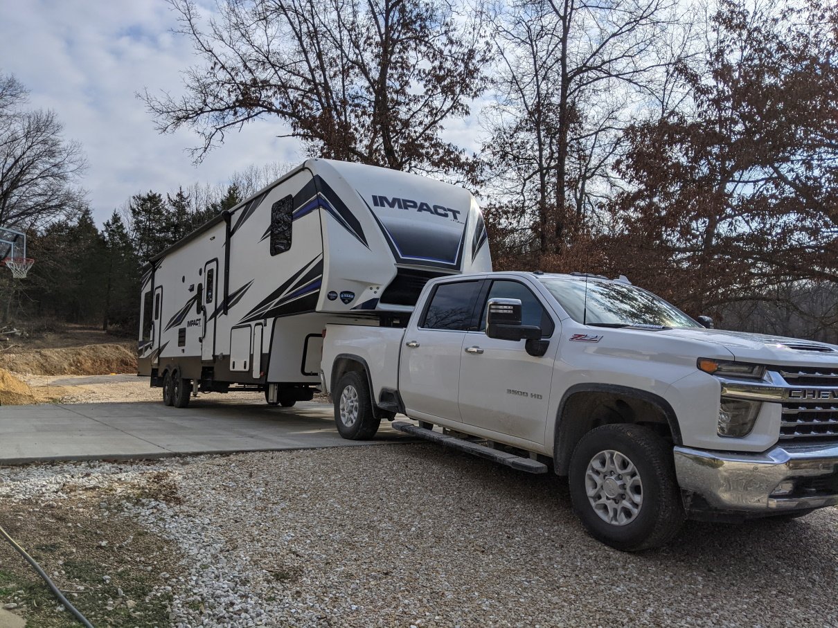

I have a 2020 Silverado 3500 and went with a 2018 Keystone Impact 351. Picked it up in Waco, TX and pulled back to St. Louis, MO area. Truck did great! I also had the dealer swap out the 5th wheel for a Reese Goosebox 20k.

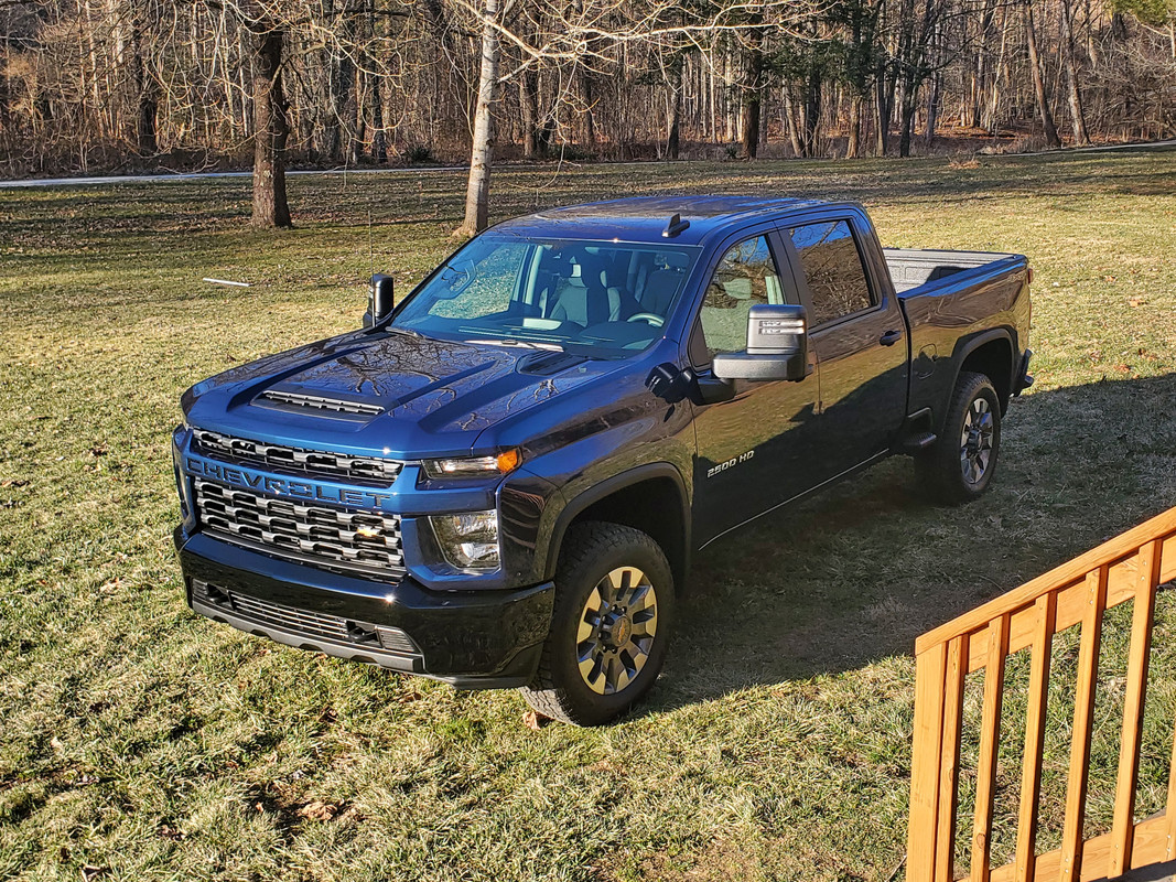

Pulling with a new 21 2500

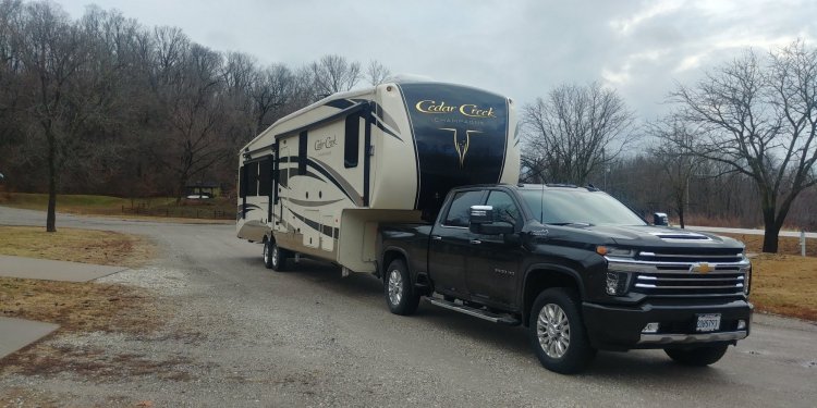

Just purchased a new 2021 Cedar Creek 377bh, have a 2500hd with a 2" level. Think ill have issues?
According to online specs for the new 2500HD if your going diesel your max payload is 3500lbs and max tow is 18500 for the crew cab SRW. If going gas max payload is 3700lbs and max tow is 14500 for tow behind and 16500 for 5th wheel also crew cab model. I did not see a spec for the hitch weight but that would be on the hitch itself. Payload is key to watch when purchasing a 5th wheel as it determines what the truck will handle as pin weight. You want to be at least 800lbs under the payload max to determine  pin weight to accommodate for passengers and cargo. Pin weight is usually 22% of GVWR of trailer. So a 5th wheel weighing 13,000 would have a pin max pin weight of 2860lbs which would work well for the gasser but might be close on the diesel. These are just max estimates as each truck has a sticker on the door stating real weights as options change this number. My advice is to go with a 3500 and not limit yourself in trailer size. The cost is not much more for the capability and you will be safer.
Dhami79, Congrats on the new Cedar Creek! The pin weight on the 377BH says 2150 lbs. I think you should be OK. As always, consider the weight of all additions. Generator, hitch, washer/dryer, tools, etc. Guessing you will be close once you add up everything but should be OK. Hit the scales once you get it loaded up so you know where you stand.
