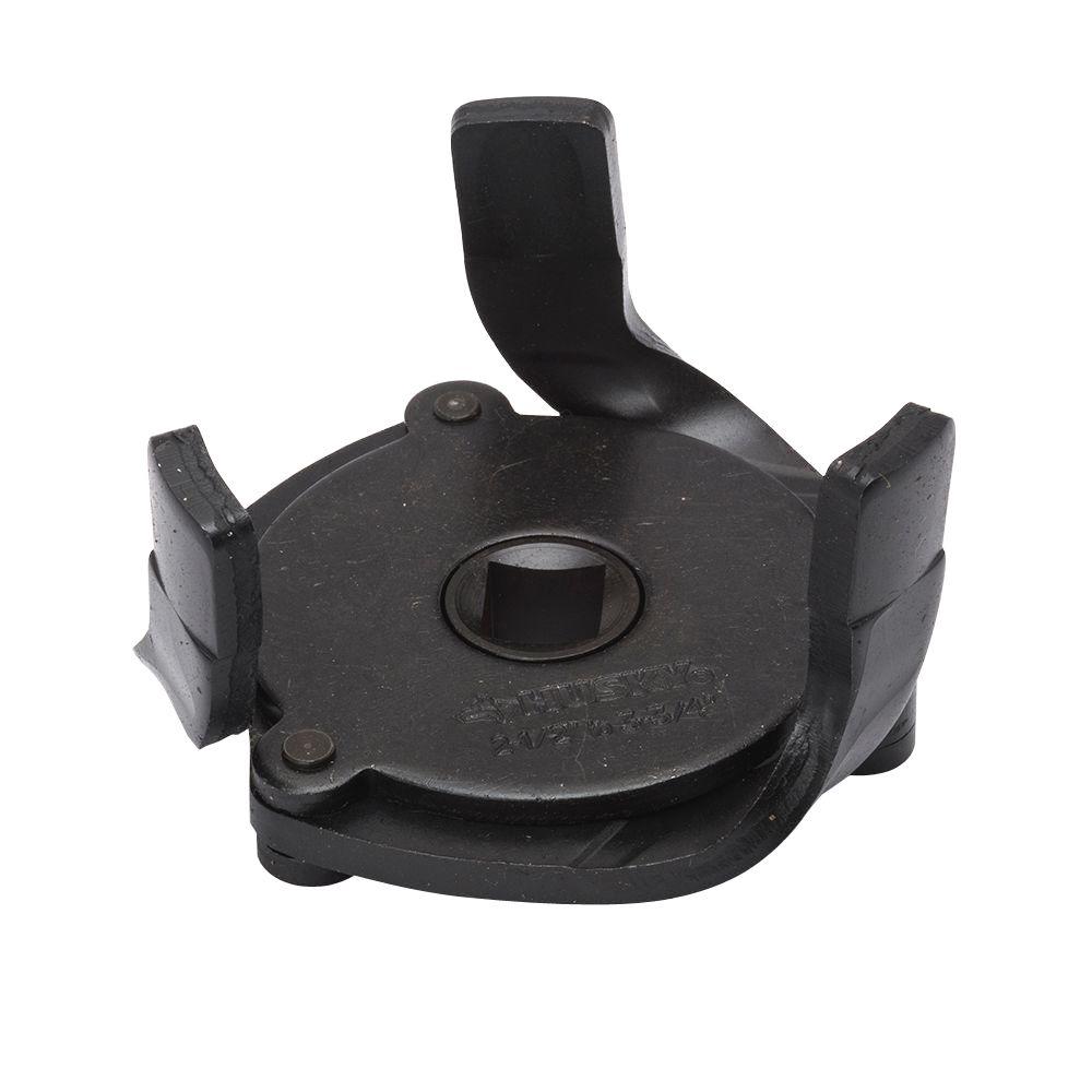

It's just a 3 jaw oil filter tool, any parts store will have one.
On my 2009 and 2012 5.3 I used K&N filters with the 1” nut because I had a hard time getting anything on the filter as there wasn’t much room. On my 20 I have gone back to the AC Delco filter and use a cup wrench. I do have something similar to the 3 jaw for a backup. I have in the past driven a screwdriver into the filter and twisted it off, but you better hope it comes off or you are towing it to someone that can.

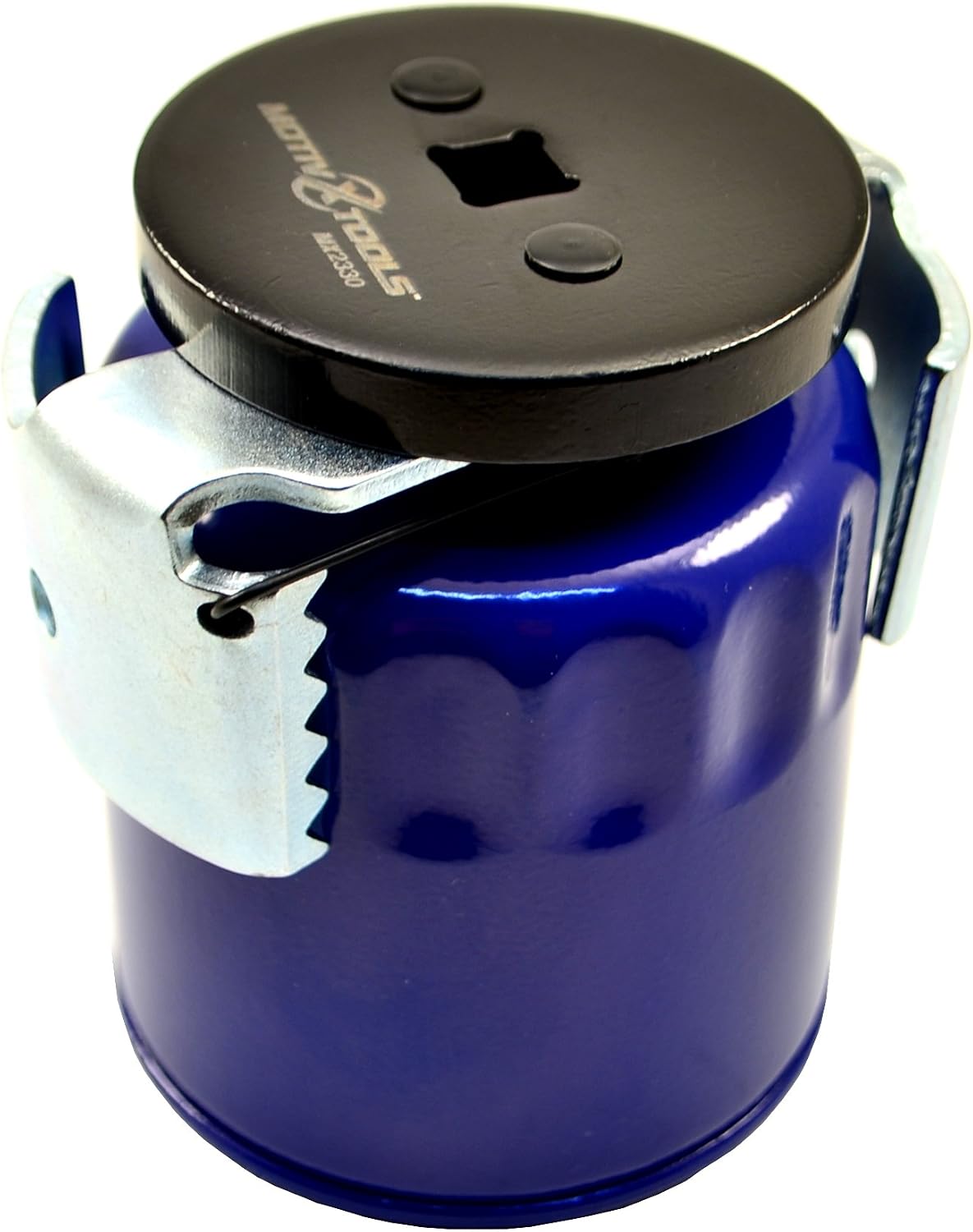

7 hours ago, diyer2 said:
This
Performance Tool B Cap Oil Filter Wrench
Agree, I've used the cap style for years on all of my vehicles, no issues.
8 hours ago, diyer2 said:
This
That's all I ever use on any vehicle with a canister filter.
