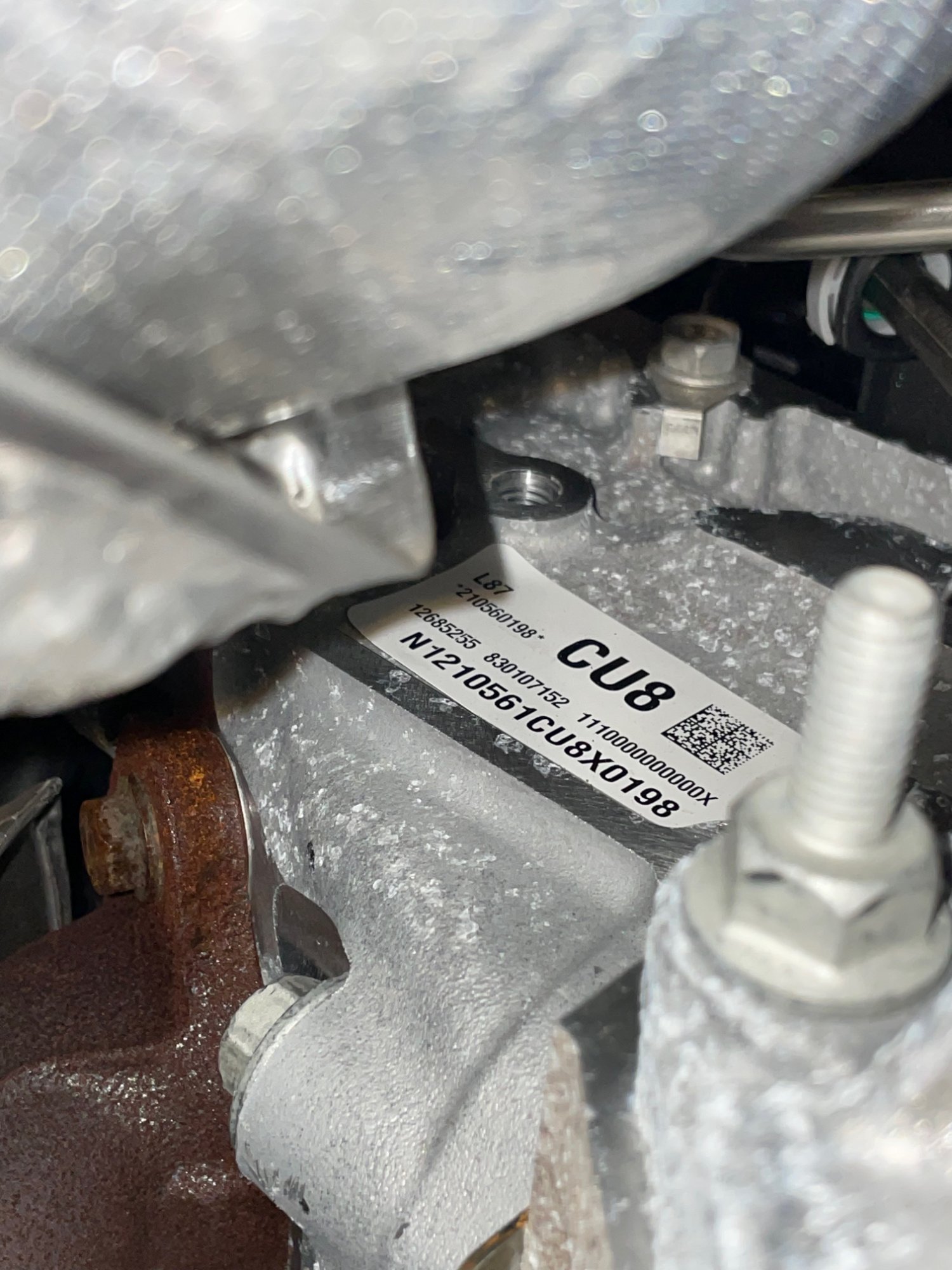

Following the thread:  2021 Trail Boss 6.2L  Julian Date from block: N121081 which should be 03/22/2021
Am in the clear on the lifter issue?
Thanks
Thanks
You should be fine. Mine was built on 3-18-21 and I have 13,000 on the clock and she runs great! Break point for questionable engines was 3-4-21.
Thanks, getting close to the 8k mark on the odometer, glad to know this issue is potentially behind me.
