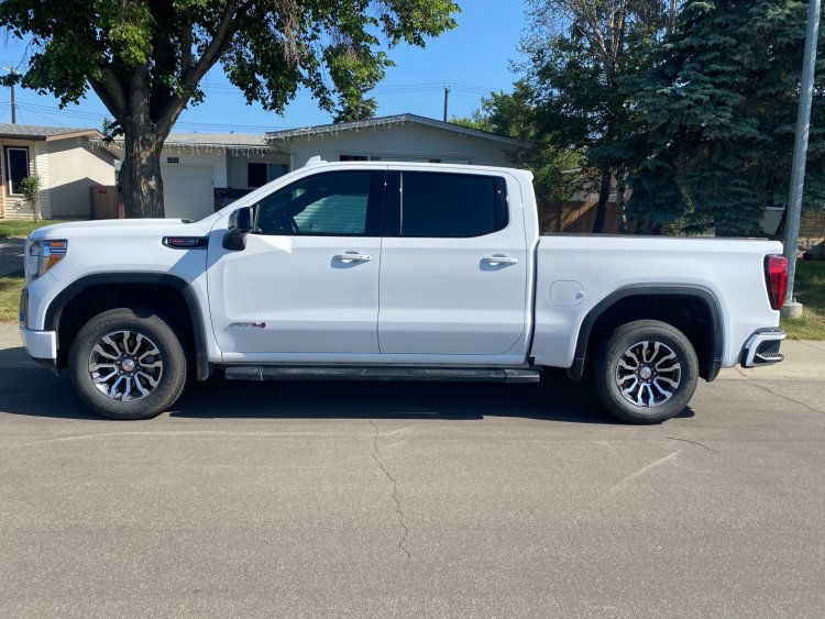

Anyone else keep getting flashed at night?  Currently on a long trip, going through Ontario and we (wife is driving at the moment) keep getting flashed by on coming traffic. Low beams on only, dont even have fog lights on. I’m in the process of removing the factory lift kit out of my AT4 for various reasons. The rear is lowered on bilstein shocks, fronts are back ordered. I did aim my headlights before we left eince the ass end is sitting lower. Center of the low beams is 44” from the ground and backed 25’ from the wall and got them aimed perfectly. The on coming traffic quickly release they ****ed up when we give a quick flash back with the 6 light mod and mirror lights to high beam (so low, high, fogs and mirror lights).
It sounds like they're not aimed correctly. You might want to double check how you're aiming them.
Probably not a great idea to flash back if your beams are already too high, plus you're adding fogs and mirror lights. It's not a war, and headlamps shouldn't be used offensively.
  • Like 3
The truck doesnt have a caroline squat. Rear still has just over 1 inch gap more then the front. I know how to align headlights, its not my first time doing headlights. And yes, ill be a douche if you blind me for no ****ing reason, ill blind you back.
People flash me occasionally...same truck...just really depends on the road.  Why are you removing your front lift?

Also, why buy an AT4 just to yank all the lift out of it?  Why not have bought the right truck from the get go?

Not the dot, didnt notice there was one honestly. But from the middle of the housing, which was 44”. Placed a line of painters tape on the wall, 44”” from the ground, backed up 25ft, put the middle of the hot spot for each light on the tape. I didnt aim left to right though.
as for ripping the lift out. Only 2 trims had the options i wanted, the denali or at4. The denali was 24k more and had a ****** load of chrome that i hate. I dont care for lifted trucks, prefer lowered honestly.  I have a back injury from the military and my sciatic nerve hates me most days. So getting in and out of the truck with the 2” is more of a challange. With my winter wheels and tires, the shark fin antenna doesnt clear my garage, it will once i remove the front lift. My bike also bottoms out when loading it in the bed. So dropping it will make it easier getting it in and out.
