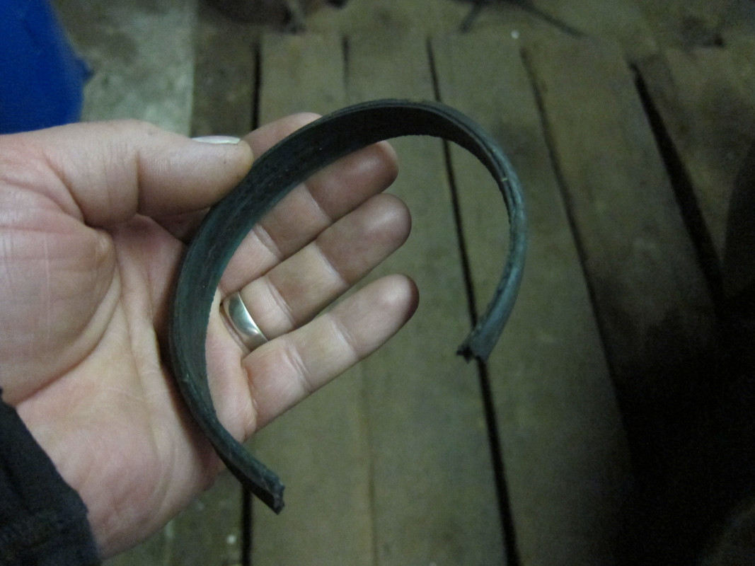

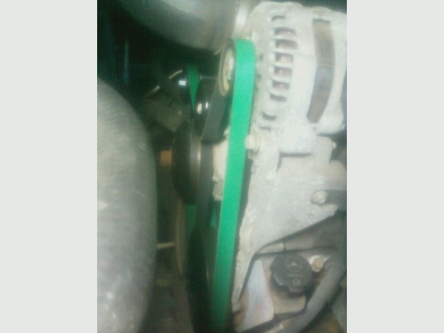

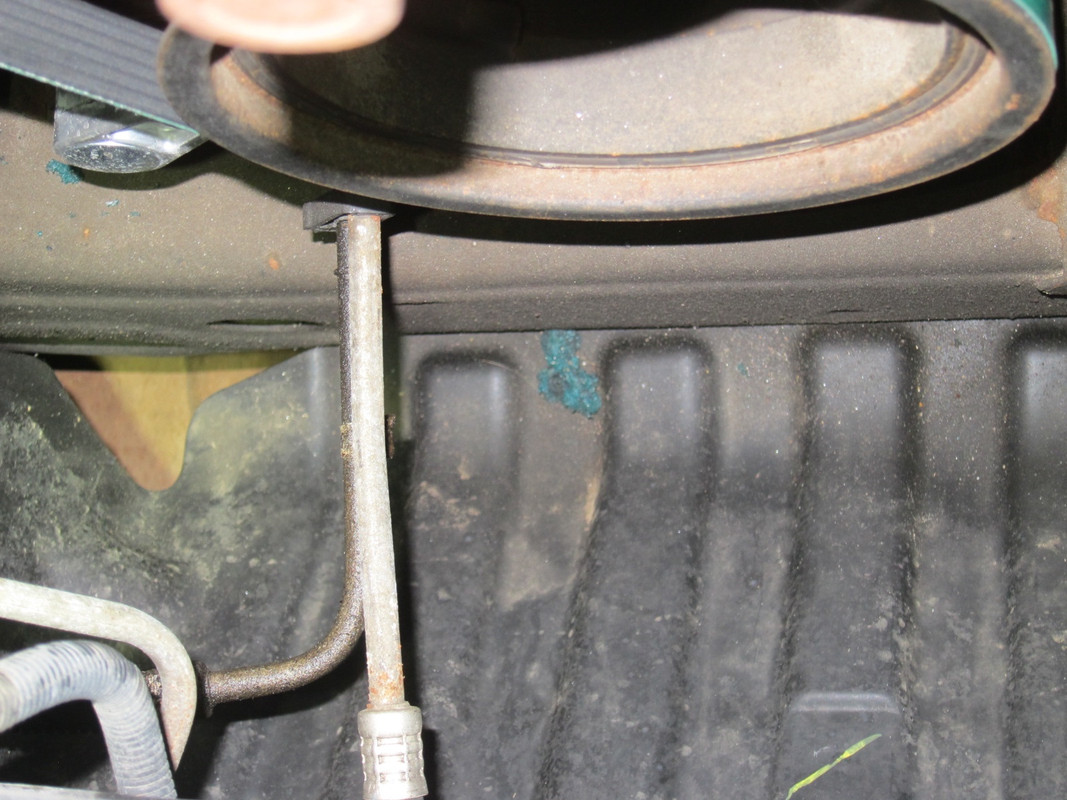

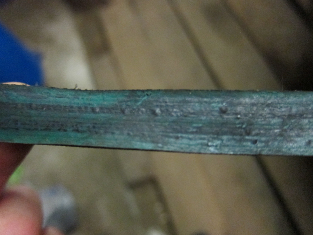

On the truck front, the Silverado finally got all new belts, tensioners, and an idler pulley, after the A/C tensioner pulley puked it's balls out, bound up on the 4 balls that were left, seized solid, and turned my Delco Fleetrunner A/C belt into a pile of green goo.This is the second bearing I've installed in the tensioner pulley - that one only made it 21k miles. SKF bearing too - used to be the best of the best. Welcome to the 21st Century.
At 76k miles, everything was starting to get noisy, so I greased up the main tensioner bearing and idler. Those were just starting to get noisy again. I attempted to grease up the tiny 6001 bearing in the A/C tensioner pulley, but that thing spins so fast, it wasn't happy with the John Deere Corn Head Grease I used, even at a NGLI #0 - guess it was just too heavy. That's when I replaced the bearing with an SKF.
While the belt was off, noticed the alternator bearings getting loud. That will fail next. Better order the rebuild kit now. 97,248 miles.
