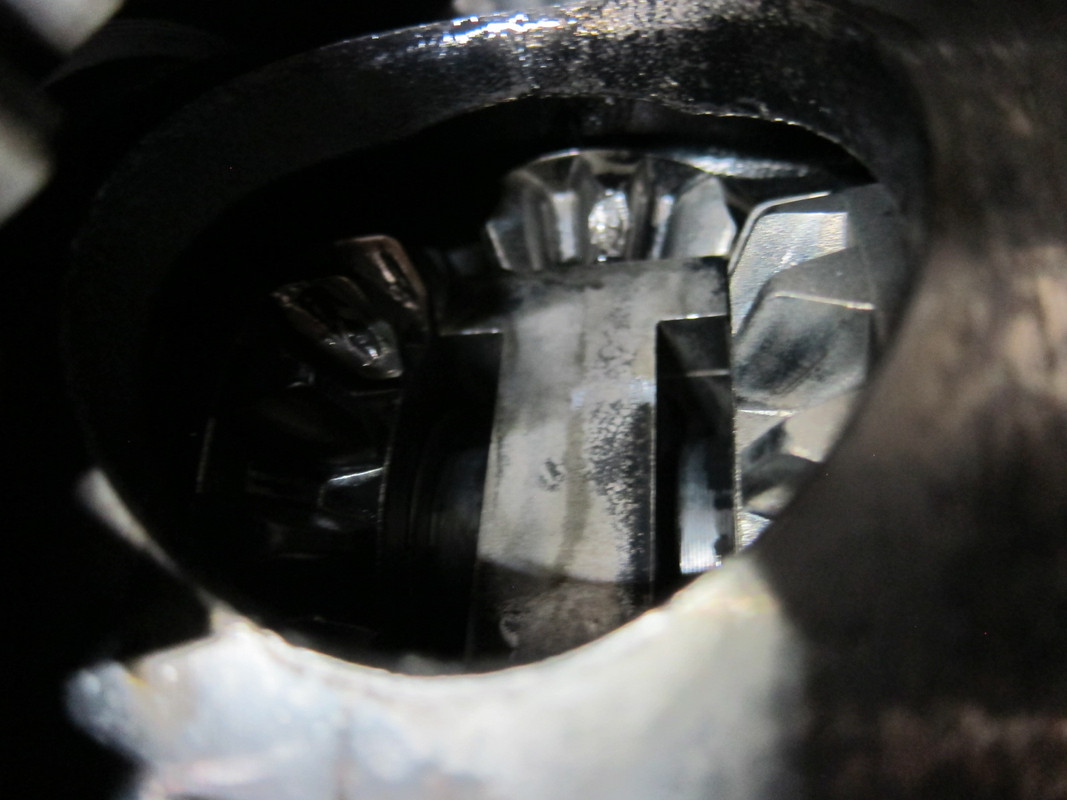

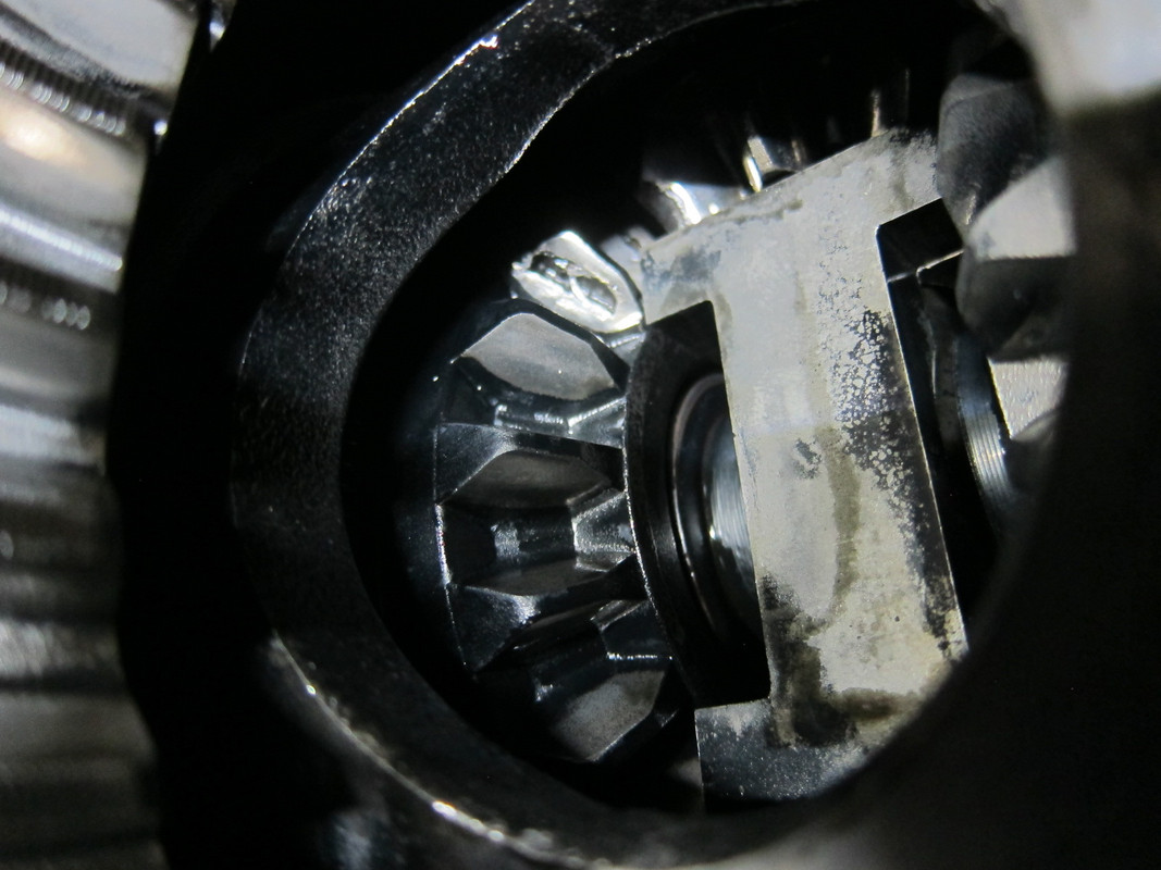

Yet another failure of my sub-100k-mile Silverado! :mad:
Went to do a spill-n-fill of the rear differential, and spotted chunks of metal in the magnet, and all over the bottom of the case. Shined the flashlight up into the carrier, and spotted damaged spider gears, presumably from the piece of crap G80, nicknamed the "grenade-lock" differential for a reason ...
So, I decided to go with a Eaton E-Locker as a replacement. I almost went with the ARB Air Locker, since I already have a compressor, but the added complexity of the internals, plus the air solenoid, air lines, and electrical that just opens the door for more things to fail. The E-Locker might not be the strongest out there, but its perfect for what I do, and installation will be super simple. One wire, a relay, and a dash mounted switch. DONE.
Parts ordered, truck on lift for the foreseeable future ... :sick:

It seems that G80 hasn't been improved much in the durability/reliability department since the one on my old 99 blew up at 80,000 miles.  Yeah yeah yeah I know there are plenty of trucks out there that see 200,000+ miles with the G80 not causing an issue.  But there are plenty where there are issues.  When it went out on mine, the axle shop suggested going with the previous gen G80 (on the 98 and prior models) as they seemed to hold up stronger, so I did.  $1600 replacement.  (Back in 2004ish)
Things only get worse with every passing year. I'll bet in 5 years, drivelines and engines will be 100k mile items, if not less ... unless there's a huge shakeup in the auto industry. I won't hold my breath on that one.
Yeah, differential work isn't cheap. My buddy had his entire rear axle rebuilt on his '02 Ram 1500 - cost him $2,200.
Yep had my rear diff rebuilt, everything but the ring gear I think. 84ishk on it. That was just a couple months ago, along with all the other repairs done during the 2 months the dealer had my truck.
