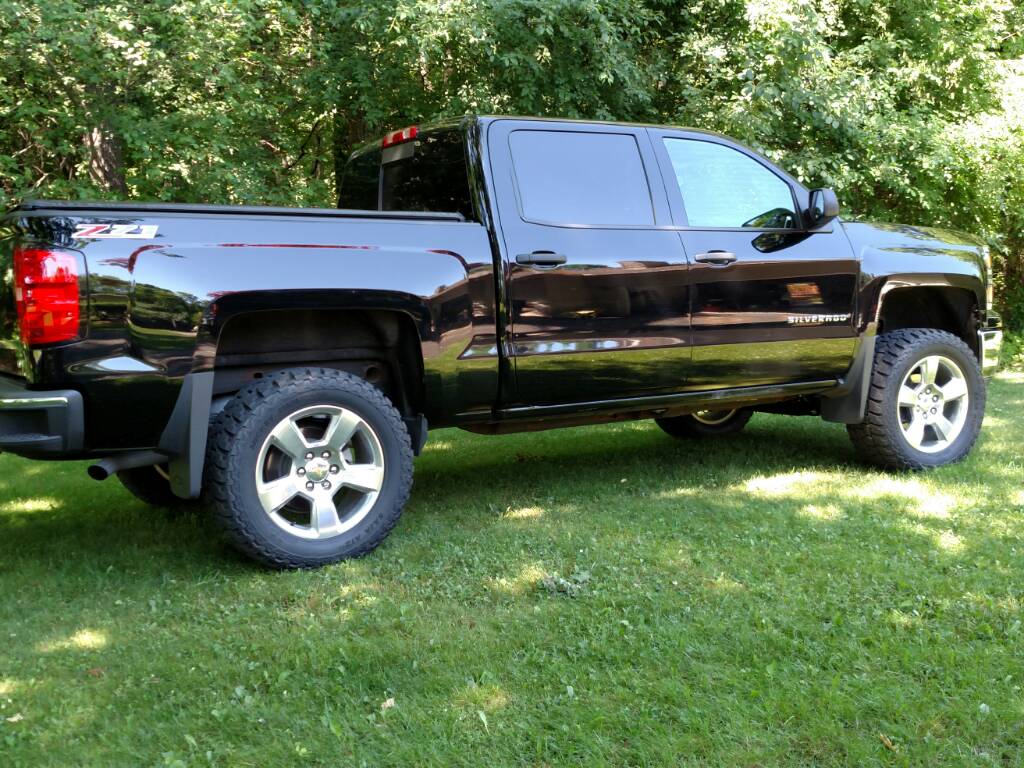

Long time reader, first time poster! Just got it back, 4"BDS with 305/55r20 Mickey ATZ.post-119348-146630170278_thumb.jpg
