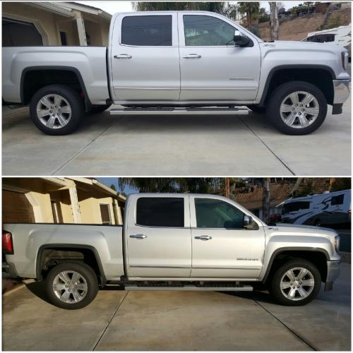

Just had the 2.25" Ready Lift leveling kit installed on my 2016 GMC Sierra Z71 5.3L
Pics? Also did u install the 2" block for the rear? I ordered for front and back yesterday. Should be delivered this next week.
Bottom is the before and top is the after. I did not put any blocks in the rear, left it stock for now. So just the 2.25" Ready Lift Leveling Kit up front. 66-3085post-152802-0-94239500-1452469759_thumb.jpg
Bottom is the before and top is the after. I did not put any blocks in the rear, left it stock for now. So just the 2.25" Ready Lift Leveling Kit up front. 66-3085attachicon.gifOptimized-2016-01-09 15.50.15.jpg
What was your height measurement before the level install? I was looking at the same kit from ReadyLift and they have a note on there that says it won't work for Z71 models because they only have about 1" difference between the front and rear? I haven't measured mine yet because I just found that on their website and I'm currently at work.
