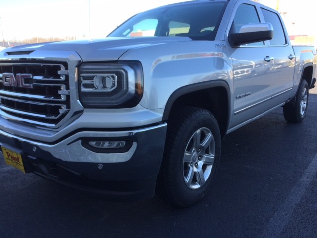

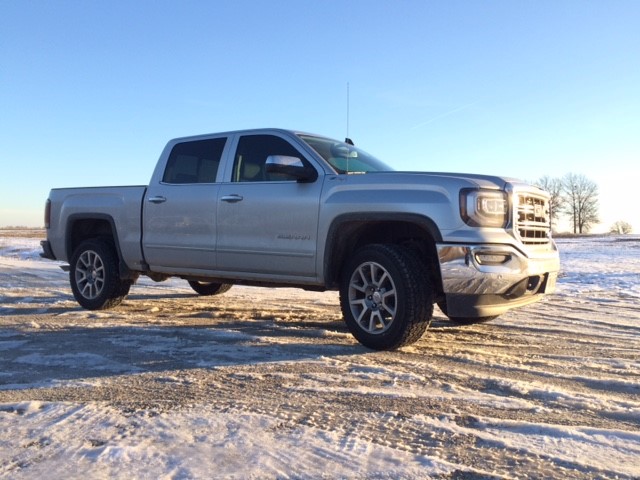

Just picked up my 2016 GMC Sierra from the shop today. 2 in RC level and 285 55 20 Hankook Dynapro's 10 plys. I'm going to be posting more pics under the thread I started as well as any changes I've noticed and MPG changes after I run a couple tanks of fuel through it. 20% tint on just front windows. More info in bottom link. I will try to get up more pics in the thread below asap!
http://www.gm-trucks.com/forums/topic/181879-my-new-2016-gmc-sierra-ccsb-z71-slt/
Here's a before
And after.. More pics to come
