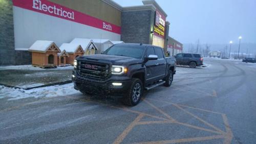

Here's a better pic of my truck. Bilstein 5100s on the highest setting and 285/70r17 bfg a/t ko2s.
I like it..... Looks very good, simple yet elegant.
Thanks. I really just wanted it to be more competent off road since I use my truck in the forest a lot and a lot of the forest roads are for high clearance vehicles. Now I'll only scrape on some stuff instead of all of it.
