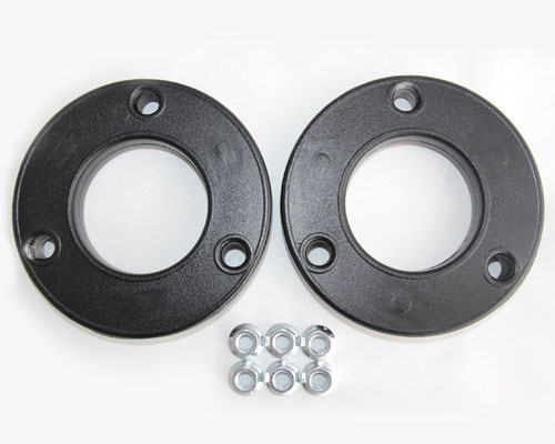

I am getting ready to order an 1.5" leveling kit for my truck and have a question.
The only two 1.5"ers I see are made by ReadyLift and FatBob's Garage. The ReadyLift is $229.95 and and FatBob's is $79.95....what is the difference? I mean they are just metal pucks/spacers. Is the RL 3X better? HaHa
FatBob's
ReadyLift
When it comes to spacers, the difference is minimal. Get the cheaper one. A spacer is a spacer is a spacer.

Thanks...that is what I was kind of thinking but wanted to make sure I wasn't missing anything when looking at them. Any purpose to the extra spaces between bolt holes on the ReadyLift? Saving weight :)?

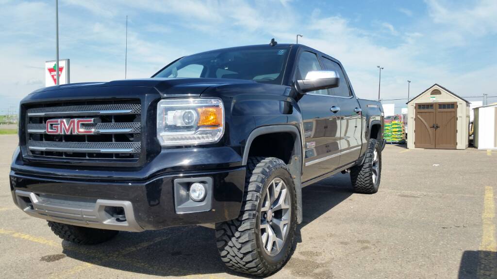

2.5 ready lift with 2 inch block in the rear. 33x12.5r20 toyo mts. Rub at full lock, but not enough to make any adjustments. Love the look, changes the truck. Recommend the level and tire combo to anyone.
That looks great! Do you have measurements? I am about to have my 2.5" level kit put on Thursday morning. The dealer wanted me to install the rear blocks but I think it will be too high in the rear. My stock measurements are 36" front 39" rear. So if I am thinking correct, 2.5" in the front will leave it 1/2" higher in the rear with the stock block.? But in your pics yours looks pretty level, just curious.
Edited by FH212
I just left back to camp for 3 weeks. Although it looks level in the pictures it still has a slight rake. Which I wanted. It's not noticeable at all, but it is nice when you're pulling something not to have it so bagged out. I removed the stock block and got the 2" installed. That's the route I would go
