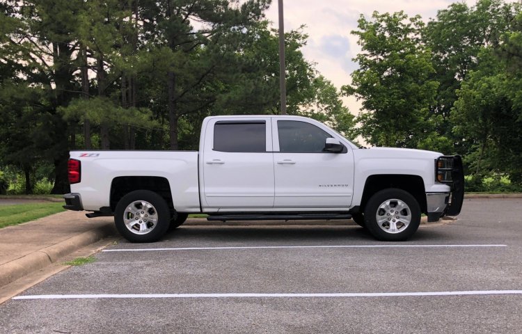

Before and After - Motofab 2.5" level on the front.  Still stock tires and wheels for now.  I definitely like the leveled look and drive and am happy with it.
Thank you to those who answered my questions about leveling on here in the past - you were helpful.  I'm glad I did it!

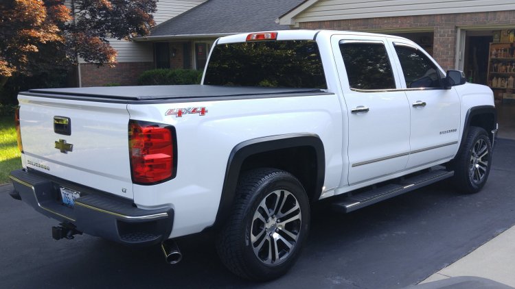

2" motofab level Atturo trail blade a/t 275 60 20. Dead on level front to back. Thinking of adding 1" rear block. Only complaint about tires are they only measure 32" tall. Supposed to be 33". But I guess this will help my mpg.
