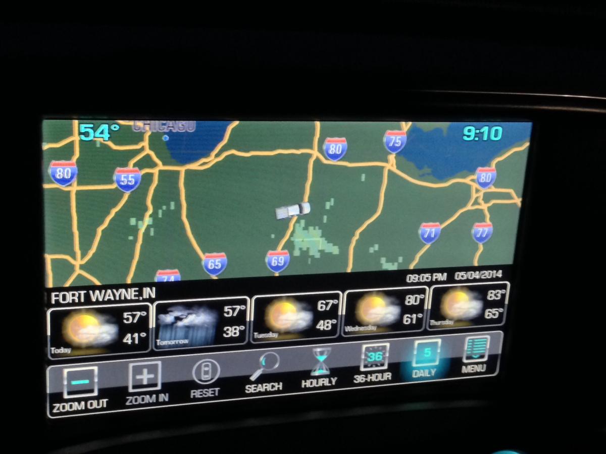

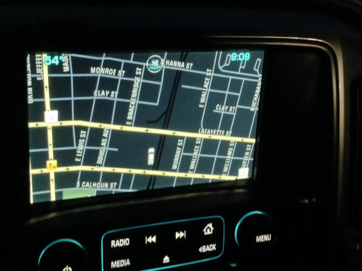

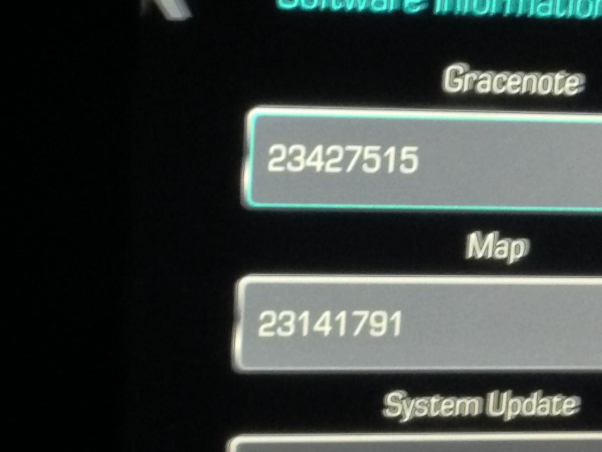

Boy this topic has sure gotten quiet. FYI for any interested partys, purchased the factory nav add on from Kodiakz and everything about the transaction has been smooth and works above and beyond expectations. NAV HMI module arrived within 4 days of ordering, took less than 40 minutes to install, no problems at all. Started vehicle and nav loaded immediately, all vehicle controls worked as before and could tell there were some additional improved settings to the factory radio, IO6. Called XM added TRAVELINK and NAVTRAFFIC, now have weather on the screen, with the weather app button that was added and travel info, traffic, fuel prices, and movie times. Took three calls to onstar and they finally added to there records that I have FACTORY NAV, now the remote link has send to in-dash nav along with turn by turn.
Finally delearship replaced radio control nobs and hvac fan nob, so back ring lighting works.
I have attached three pictures of end product, first one shows maps screen, second one shows weather screen, and last one shows updated software numbers. Note the back ring lighting working.
