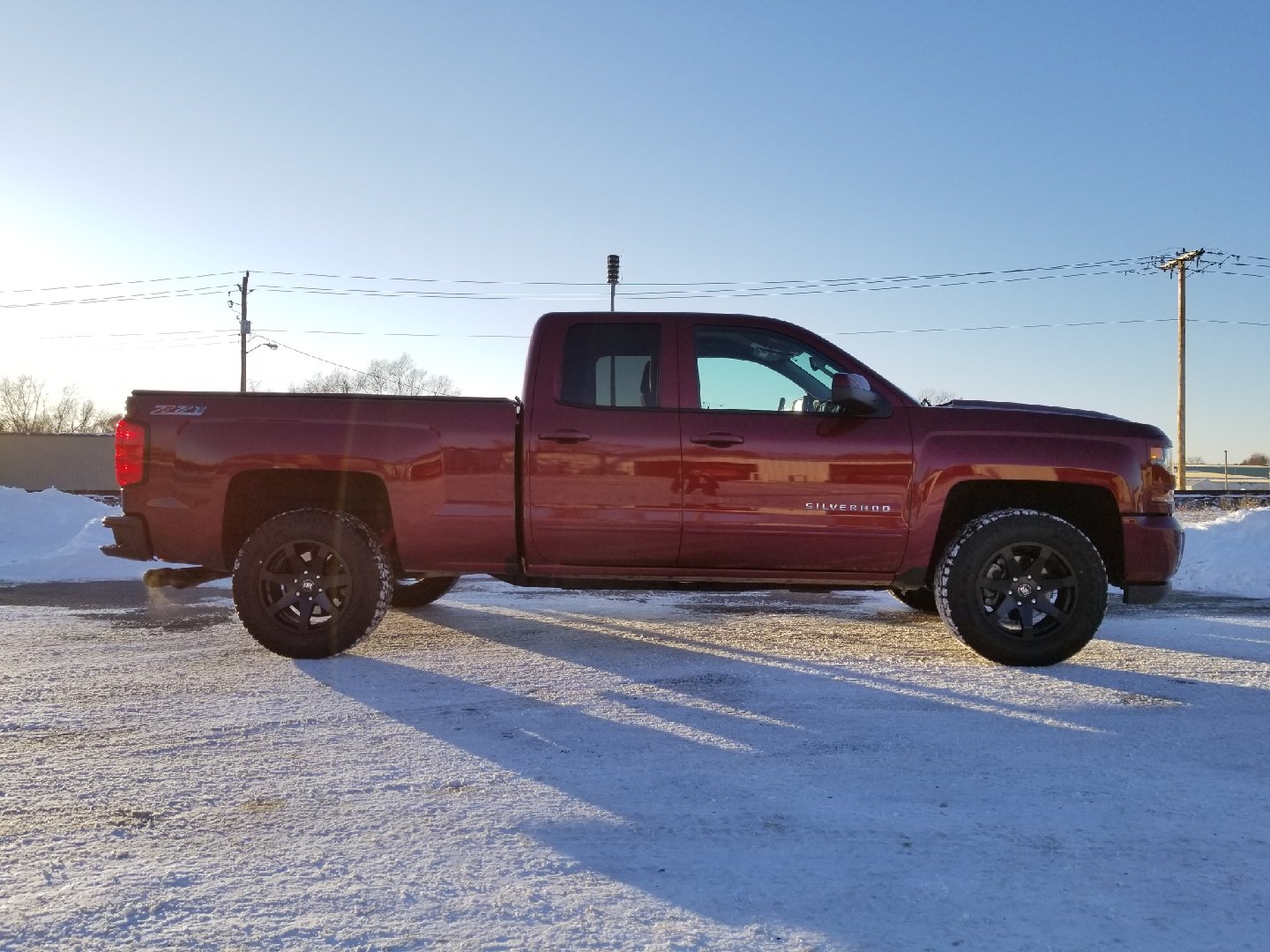

Switched up my exhaust from a side exit behind the rear tire to in front of the rear tire. Has a little deeper tone without the extra pipe. Still very little drone and more sound in the cab which I was hoping for. Let me know what you think.
Looks great! You should level it out, I’m looking at a BDS leveling kit and if you’re keeping the stock suspension it’ll run you under $150 excluding labor if you’re having someone put it on
