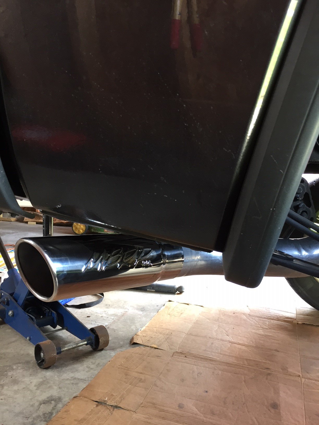

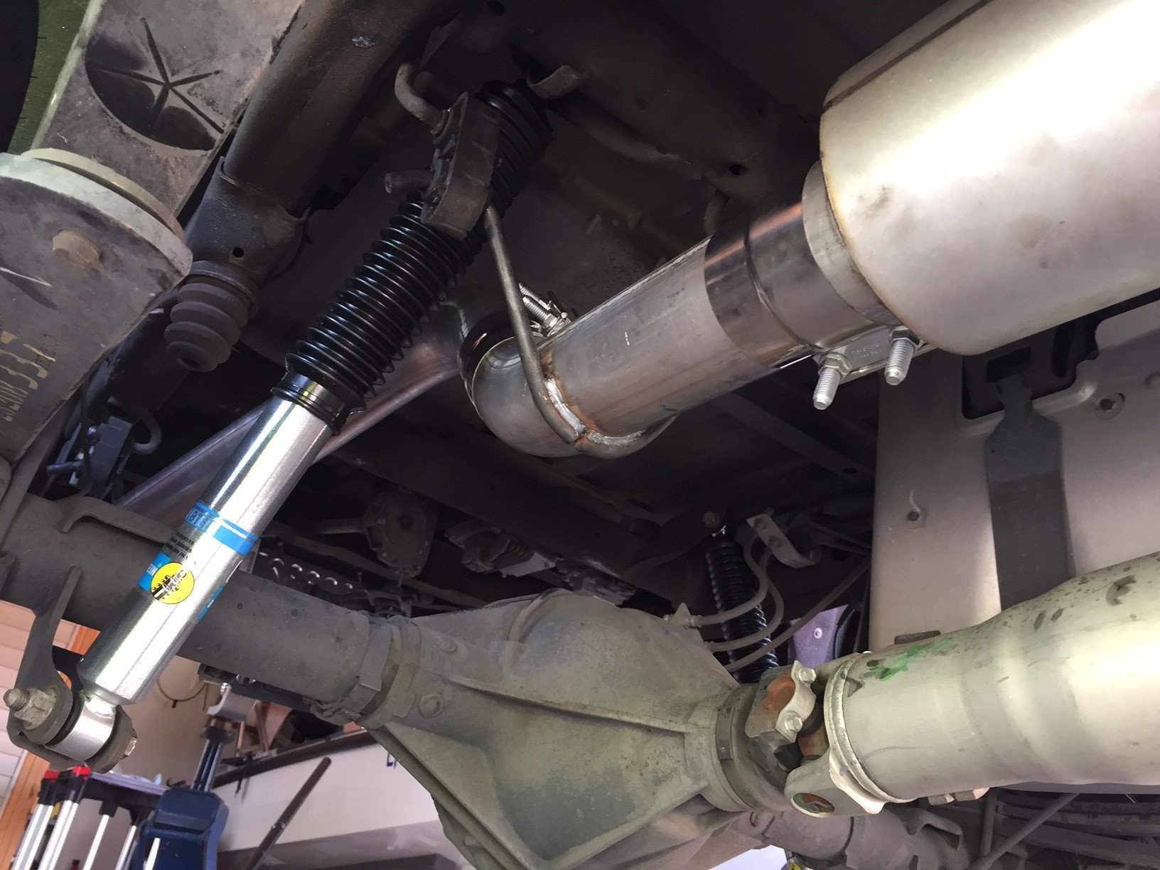

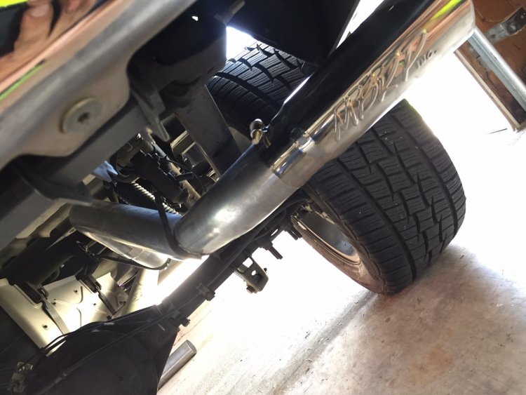

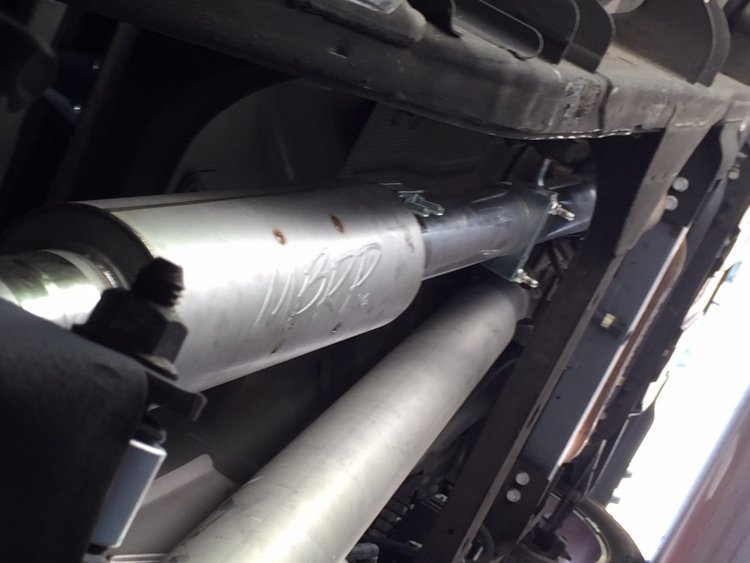

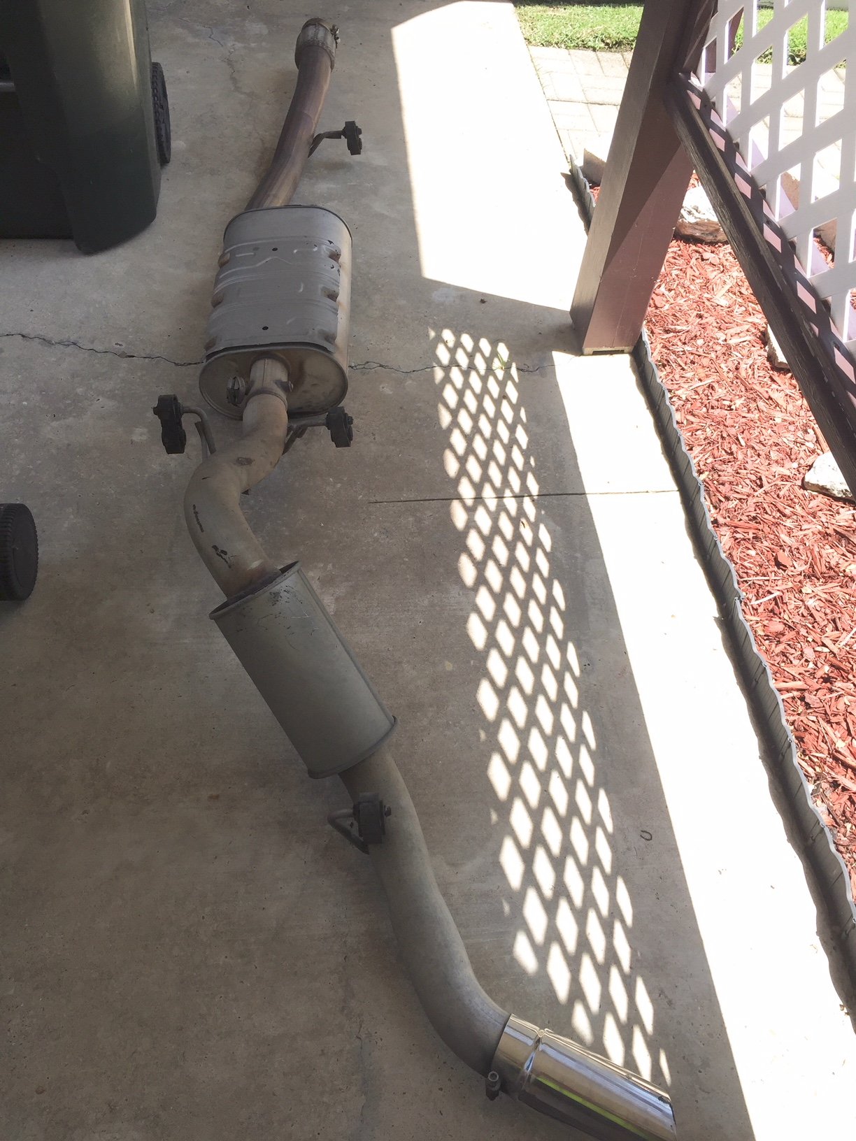

Finally bit the bullet on an exhaust...  I was itchin for a little more power and sound.  Ended up with the MBRP Aluminized S5086AL 3.5" system after some good reviews of the sound.   Very happy!  Found a killer deal in the Amazon Warehouse..$268 shipped. Parts came in brand new, intact, and with all hardware. Score! I decided to order the Summit SS lapband clamps to use for connecting points instead of the U-bolt clamps so no crimping.  Got the old sewer pipe out in 1pc just in case I wanted to swap it back for some reason.  Installed the new system sewer system piece by piece and everything went together perfect although I did have to massage one hanger.  Snugged all the clamps checked for clearance, then tightened them up.  I'll do a recheck of all the clamp bolts after running a few hot/cold cycles.  Sounds really good!  It's quite a bit louder but I like it.  It honestly feels like there is more usable power down low.  Seems stronger on little bursts when I mash the go pedal.
