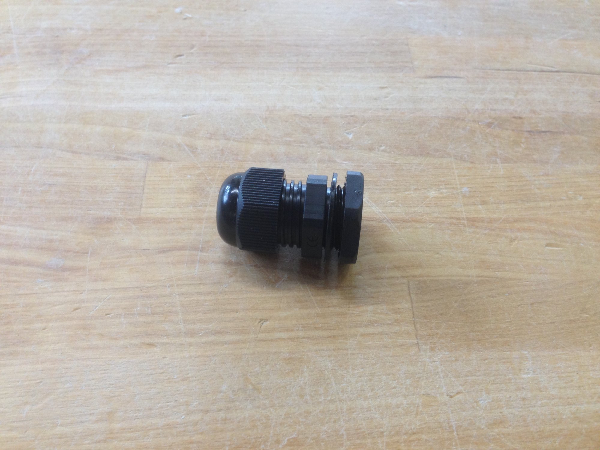

Marv88 Posted December 28, 2018 Posted December 28, 2018 Finally got around to running the power wire for my audio system. After reading/seeing how much of a pain it would be to go through the firewall I decided to go under the truck. I ended up finding a plastic plug that was right below where the amp will go so I drilled that out and installed a compression style waterproof grommet. 1
Marv88 Posted December 28, 2018 Posted December 28, 2018 I cut a bit of the foam carpet padding out and cut an X in the carpet to fit snugly around the grommet. 3
