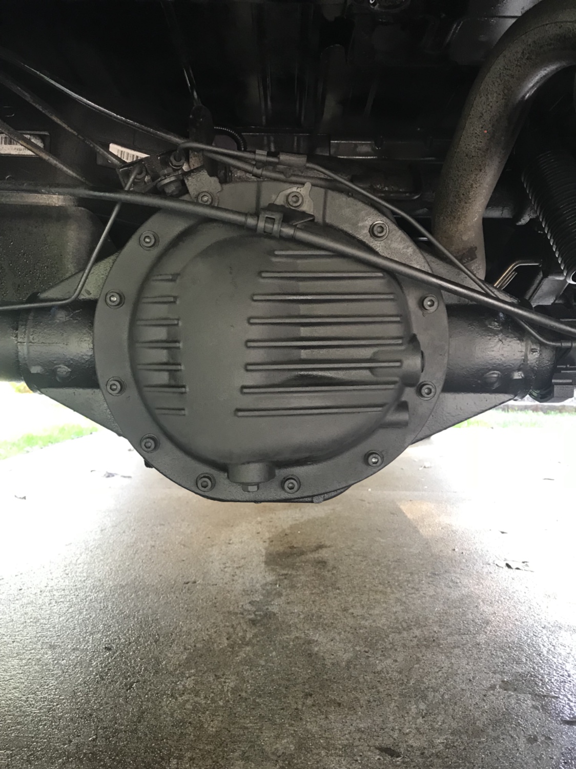

I just run Amsoil severe gear 75W-90 and I have an auto-locking diff. I don’t use any friction modifiers. I have 4.56 gears and I’m very happy with it. I read quite a bit about diff oil prior to pulling the trigger on new gears and the Severe Gear is right at the top.
I also have a PML diff cover. A few benefits to the cover. Drain plug, increased fluid capacity and a place to tap into the cover for a temp sensor. I also think it’s the best looking cover. I got mine plain in aluminum and painted it with Rust-Oleum BBQ paint (not the premium, just the standard one). That was 6 months and 2,500 miles ago before the winter was in full force. Still looks great. This was the first coat, the second coat fixed the inconsistency near the edges.

Where is the fill plug?
Looks like right side of cover at the same level as centerline of axle tube.
Pointing right.  Not back at you.  You can only see the side of it.
I know that is enough oil but still worries me. Always feel.like there should be a little more to cover the pinion seal.
