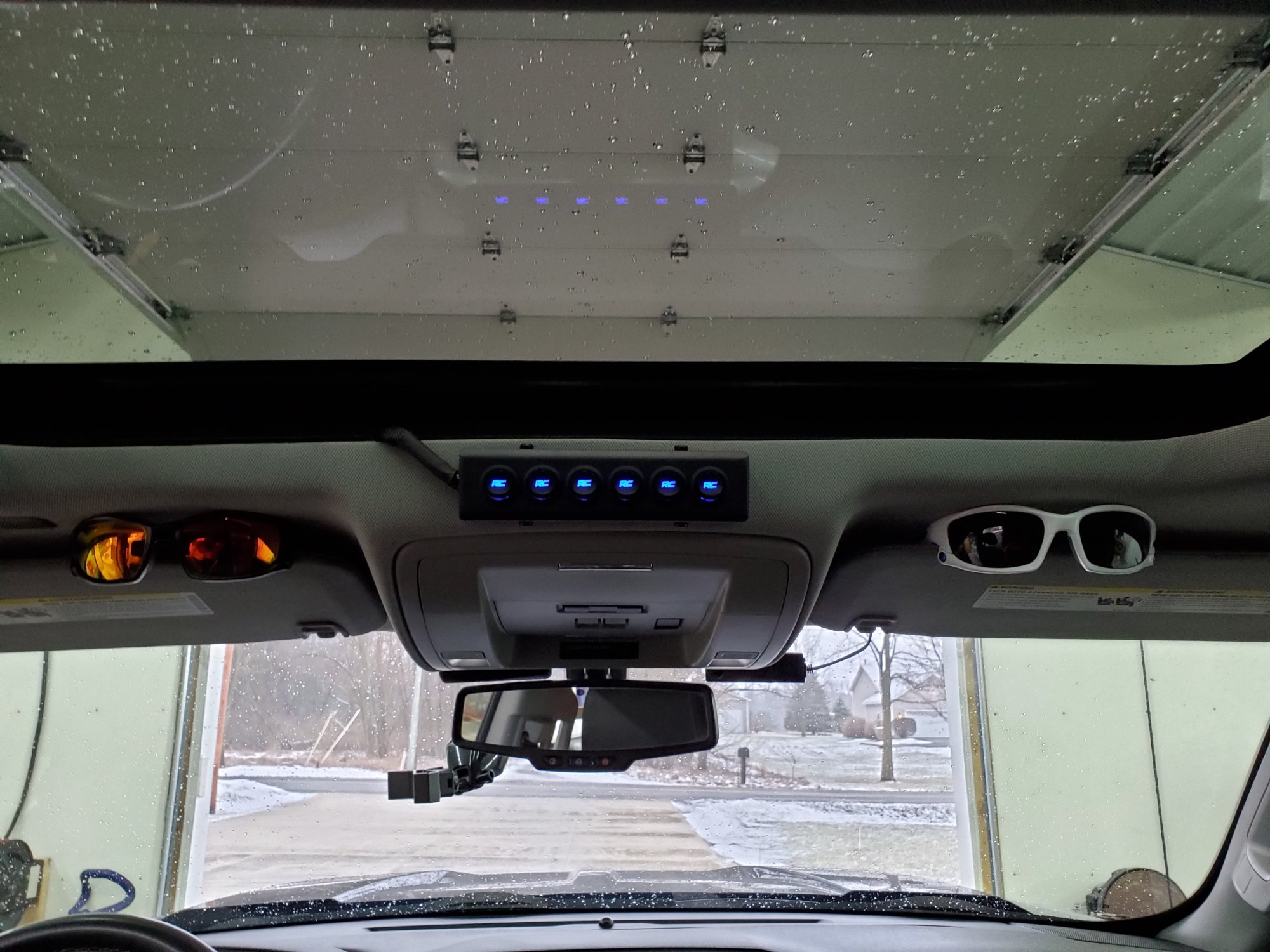

What switches are you using? Link?

Rough Country universal, don't look back...
