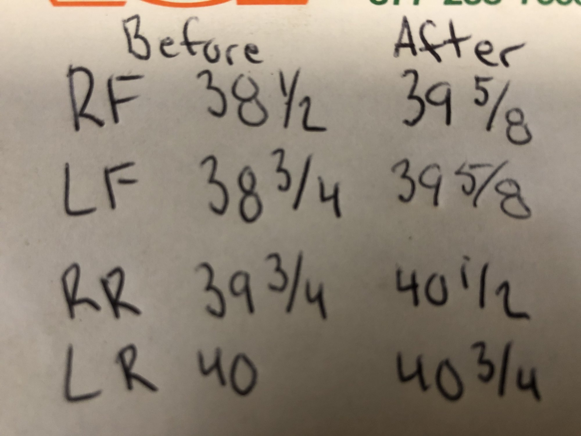

Got the front Shocks and springs on today. Gained 1” over my 1-3/4” leveling spacers. The factory springs had settled 1/4” so the Eibach springs lifted it exactly 2-1/2” higher over stock height. Fender height measurements are with 32.5” tires. Went for a short drive on county roads and the ride and handling seems much improved.

 Looks great! Do you have any pictures of the truck since installation?
Did you use the 2nd notch?
I'm doing this exact Eibach upgrade in a couple weeks.
Thanks. I’ll snap some pics later today.
I set them on the lowest notch. That leaves me with only about 1.5” of down travel in the front suspension. I would be leery of setting them on the second notch since that would leave you with less than 1” of down travel.
If you’re planning on doing the job yourself, these Eibach springs are no joke. My spring compressors are built heavy duty and the 20mm diameter screws on them were flexing under the stress.

Wow that looks great. I guess I didn't realize the 1st notch gives that much height.....really no need to go to the 2nd notch for me.
You're right about the massive springs. I'll remove my springs & struts from the truck, then I'm paying a friend to swap them over in his garage. He has heavy duty spring compressors, whereas I just have smaller compressors. Plus I'm chicken. :D
Thanks. To me, it actually looks a little higher in person.
