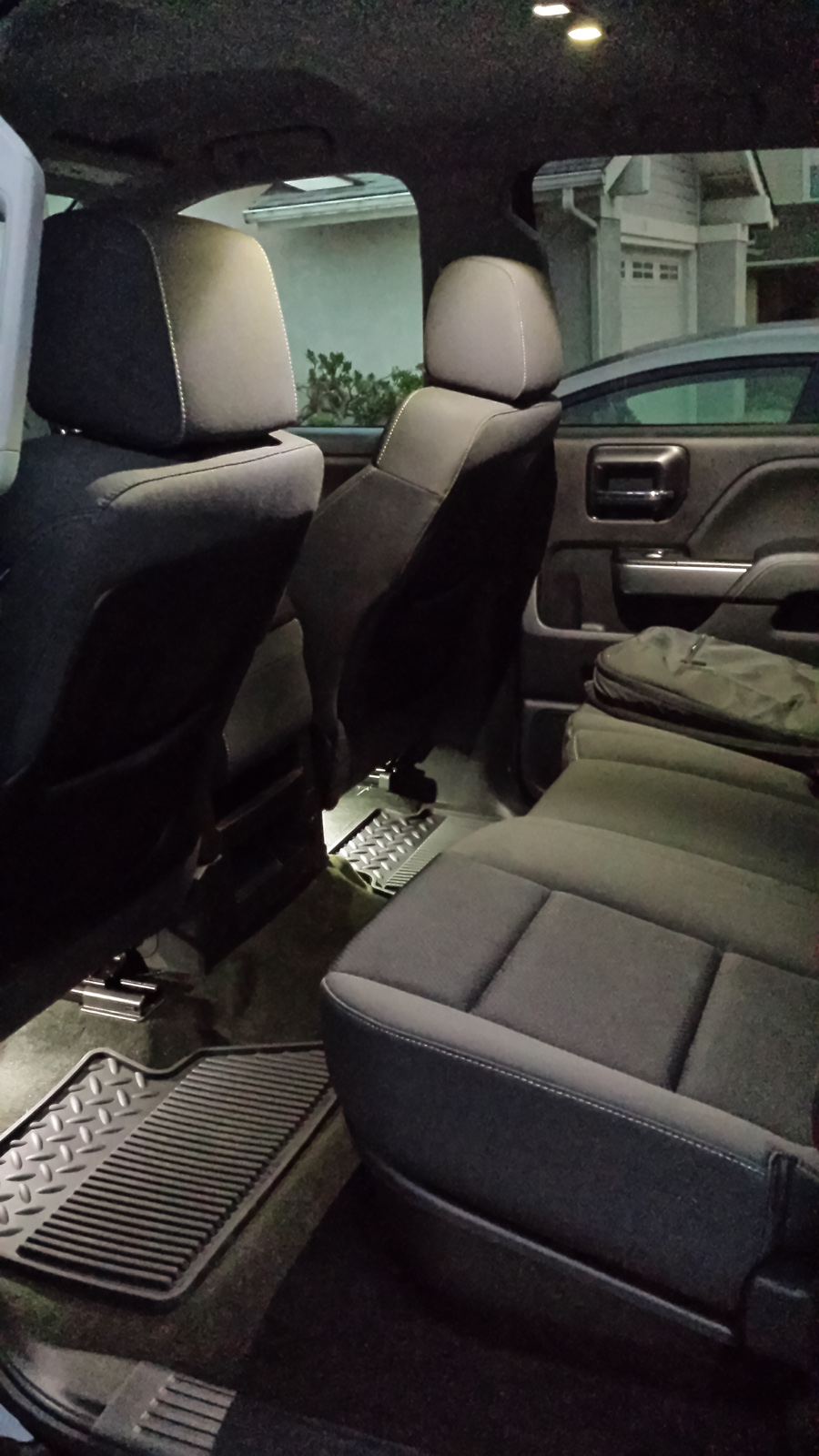

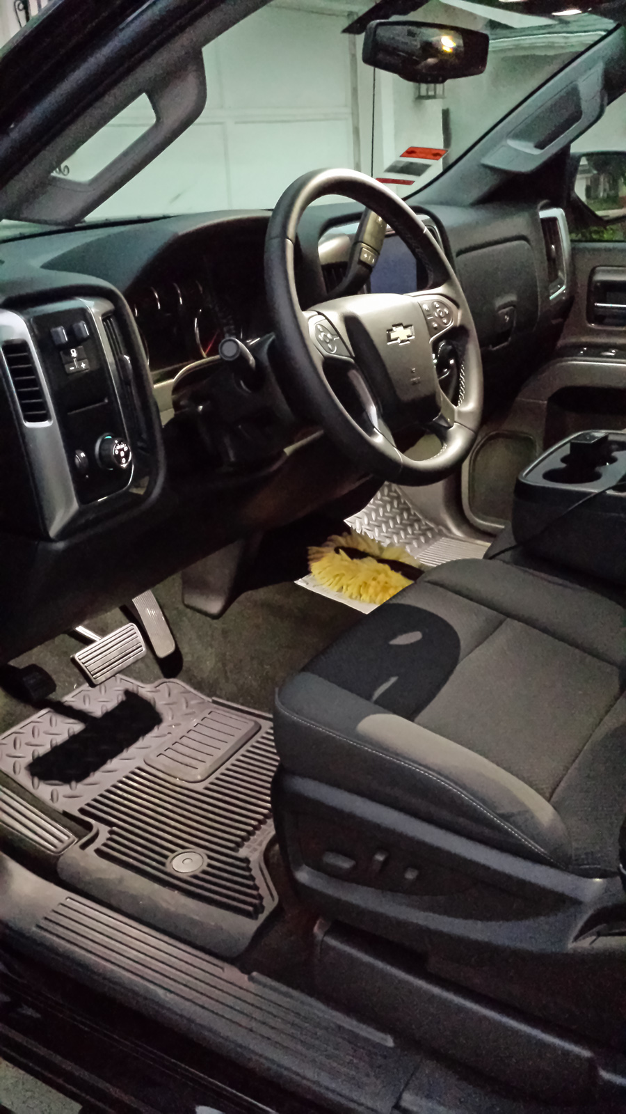

Oh Yeah, I also finally did the footwell lights modification, both front and rear. Beats me, as to why GM cheaped out on the most simple of things, like this. My service advisor that took care of my radio and climate knobs was surprised to see them and actually really liked them. Wondering if I can do the same to his truck. :ninja:

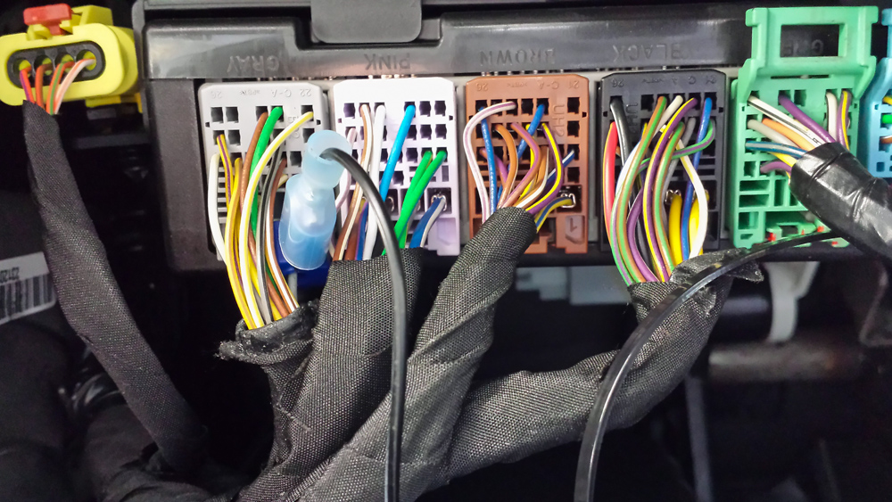

Ive been wanting to do this...
what lights did you use, where did you tie in and where did you run the wiring for the rear ones?
I think I also want to do an ambient light that is on at night too.
I used the white XKglow pods (http://www.xkglow.com/60PC_Ultra_Bright_Motorcycle_LED_Engine_Neon_Kit_p/xk034001.htm)
As for the wire I tapped into, was fairly easy actually. I found another wire under the dash(driver side) that controls the dome lights. So when you unlock the truck or open any door, all the lights come on. Many members here found the actual wire that goes up to the dome lights on the ceiling/headliner, which is in the black box under the dash as well but it's hard to work and tap into it See (pic 1) of the wiring harness I used to tap into. In order to run the wires to the rear seats, I went under the carpet on the driver side/under dash to the trim pieces that go along the door frame. Continued to run the wires under the trim pieces, till I got the B-pillar to come across the driver seat frame/trim piece.(pic 2) I pushed the door frame trim piece as much as I could to show the white wire coming across and under the driver seat.
