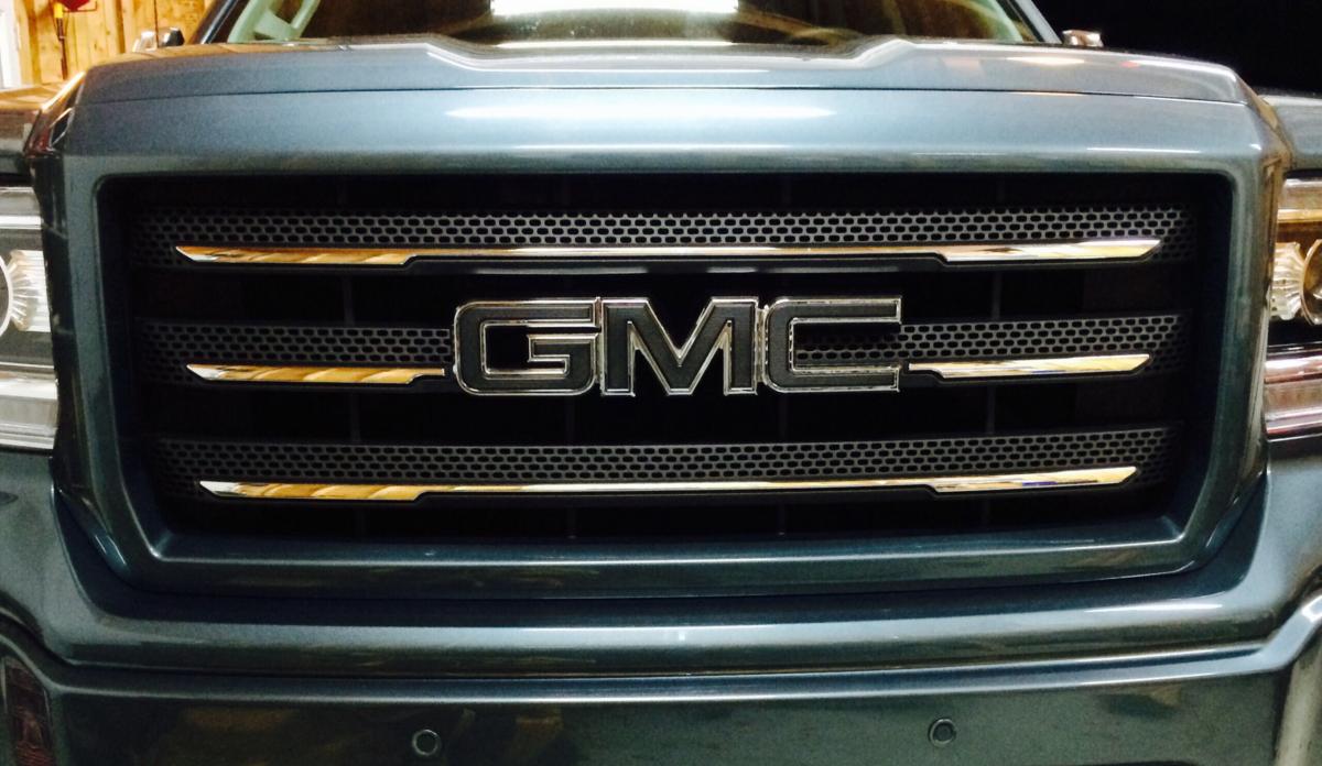

Time to find a new shop. I got both my front and back emblems done with vinyl and they look great. Also a local dealership here in Houston has the vinyl done on all the trucks on the lot and all look good. jy6y5eju.jpg
Plasti dipped my emblem and grille. I did 5 coats on the emblems and 6 on the grille. Very easy and saved me a ton of money.
your truck looks great. i have the silver gmc double cab and was looking to go with black emblems as well
