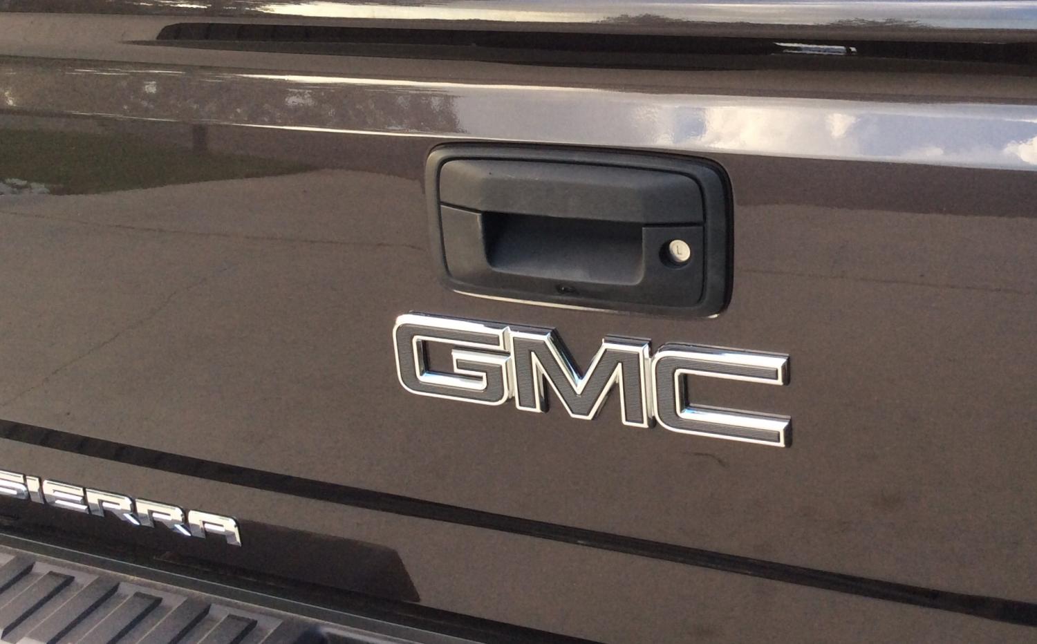

I ordered some Iridium Metallic paint and completed the rear logo. Three coats of paint and three coats of clear. My only beef is that the metallic did not show as well as the factory paint. So when the sun hits, it does not match well, but if overcast then it looks right.

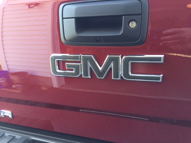

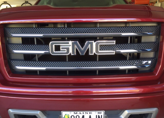

Plasti dipped my front and rear GMC emblems yesterday. I also added the Z71 emblem to the grill. This really was a cheap mod that looks great. Thanks to you guys for laying the ground work on this!post-50660-0-36598700-1435285794_thumb.jpgpost-50660-0-20699700-1435285808_thumb.jpg

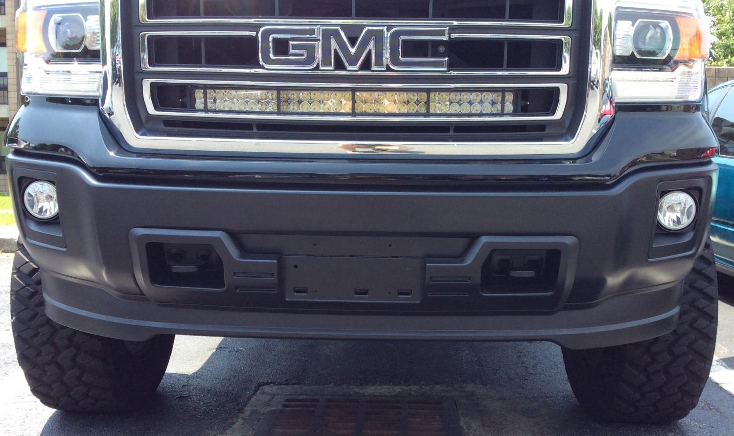

Used Matt black dip and glossifier
Did 4 coats of the black with 20 minutes dry time between and 2 coats of gloss

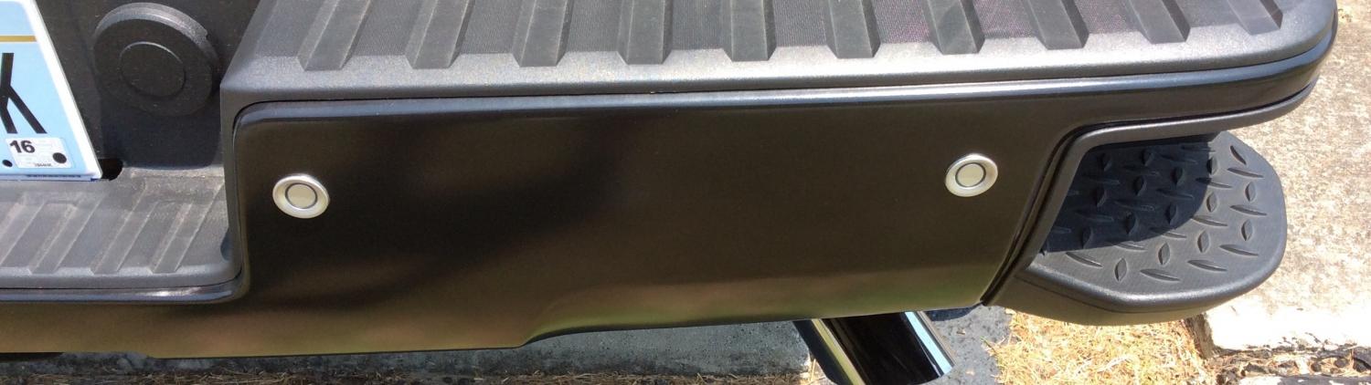

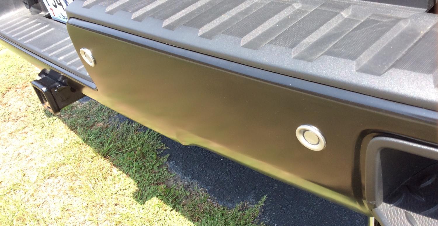

I painted my front and rear bumpers yesterday. The front bumper i did several coats of black and glossifier. It came out pretty good but has that texture that seems to come with plasti dip. My rear bumper however I did in one heavy coat. There was no running and I made sure everything was covered. Then I hit it with one heavy coat of glossifier. I will admit I messed up a few spots with the glossifier due to it blending with the still wet black plasti dip. I may have gotten a little too close.....but it is smooth as a baby's bottom. No texture what so ever, and it looks awesome. Posting pics soon.
post-142991-0-84562100-1437323877_thumb.jpgpost-142991-0-00996300-1437323888_thumb.jpgpost-142991-0-07069400-1437323907_thumb.jpg this was 3 coats of black, and 3 coats of glossifier. It came out pretty good, but I am going to try to perfect the one coat application. It gives it a lot better appearance in my book..
