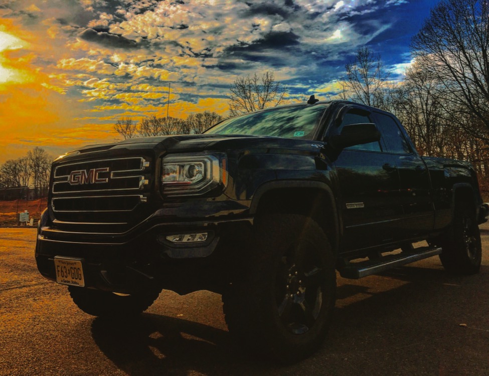

D
2016 Chevy Silverado LS Z71 4x4
FUEL Offroad Hostage 20X9 +1 Offset
BFGoodrich K02 275/60/R20
2.5" Front Level
Zero rubbing with this set-up
vvXGAXt.jpg?1
xEs9ZYf.jpg?1
nY9l59R.jpg?1

Dirty, but the best picture I've gotten of it. OEM Machined Denali Wheels. 275/60/20 Ko2s. Stock Height. No Rubbing.
BFGoodrick K02 75/60/R20
2.5" Front Level
