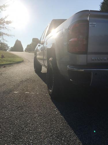

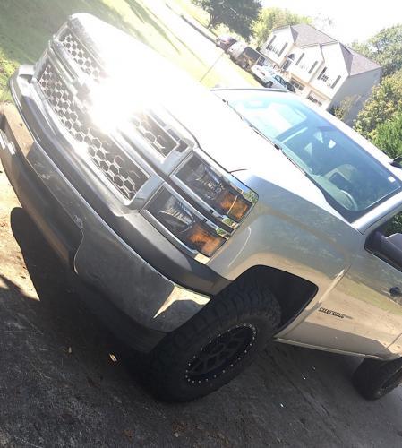

Got my new rims and tires put on. 295/70/17 ridge grapplers on Method mesh 0 offset. Haven't had any rubbing
What is your lift set-up?
It's not necessarily the tire size but the corner lugs you need to look at. Some tires round in before starting the lugs and some start on the side wall. Typically a more aggressive tire will have the lugs starting from the sidewall which can rub. It's a major difference between a passenger/AT tire and an MT tire like the Duratrac.
Caster and camber can also affect where and if it rubs.
