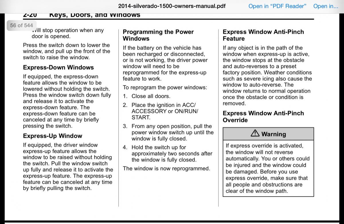

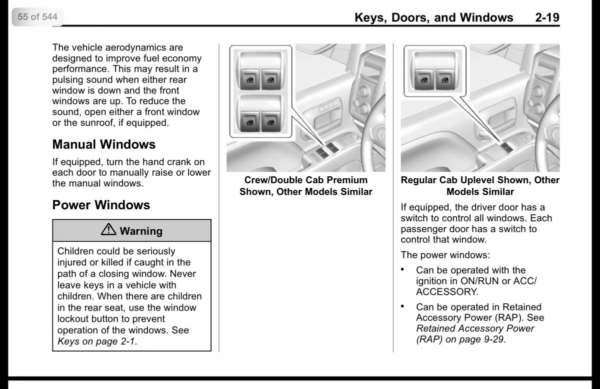

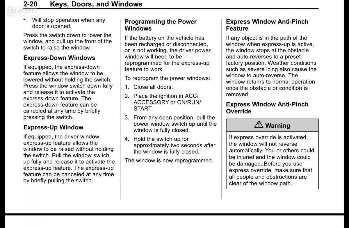

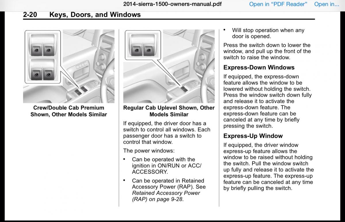

Extracts from the owners manuals. Key word, "window vs windows".
