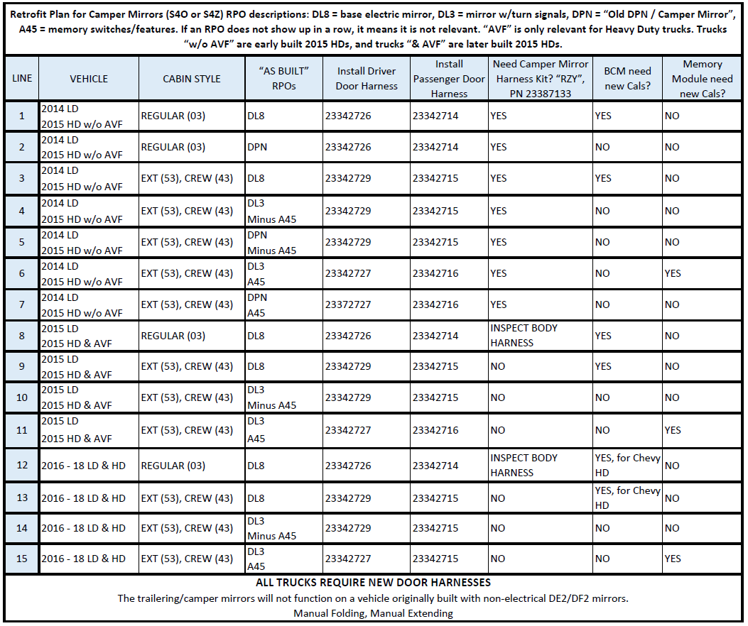

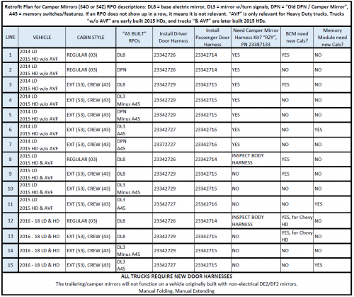

Take a look at the Vehicle Acceptability for Retrofit guide. It doesn't state 2017, but after evaluating the pin assignment, it appears to be same as 2016. If you have the RPOs DL3 and A45, you would be the last truck listed. If you have DL3 and don't have A45 (Seat Memory), then you would be the 2nd from the bottom. Keep in mind that if you do have DL3 and A45, there is a Memory Module Calibration needed. In this case, I would check with the Dealer for next steps.

If you do have Seat Memory, then I would say that you are the bottom list of the retrofit.
I would recommend dealing with the Dealer as the list shows Memory Module Calibration required.

Once again, the part numbers I listed are the most recent and updated part numbers for the harnesses that you're going to want. I went to the dealership and found a truck with every single option possible on the towing mirrors and then confirmed with GM Parts Direct and everyone here that has DL3 mirrors that wanted towing mirrors with ALL options.
I have memory seats also and every option working that the mirrors have, including memory and have not had to have any type of calibration. And the guy on here that confirmed my part numbers has a Denali.

I have codes DL3 and A45.
I did the trailer mirror swap this weekend using these parts numbers.
Mirror kit 23372182 (I wanted black mirrors and did not care about the power fold)
harness 23342727 and 23342716.
So, after install, the power mirror (big mirror) no longer works and neither does the memory seat recall.
Everything else works properly though, blinkers, heaters, park lamps, cargo.
I have an appointment at dealer today to have the memory module calibrated. Hope they understand what needs to be done and hopefully the power mirror and seat memory work again.
