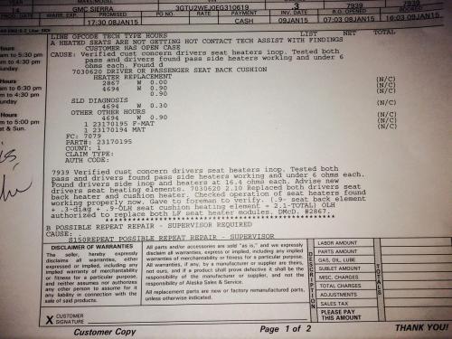

01/10/15 Update to threads #32 and 35 above - GM corrected seat heat fault
Pleased to share here that as a result of my filing a BBB Auto-Line complaint, GM Corp/GMC responded well and further, worked with my local servicing dealer to repair a seat heating function fault in '14 K1500 Sierra Denali.
I picked the truck up this morning following 2-days from my servicing dealer and the seats are heating properly and just as they did when the truck was purchased 1-year ago. The attached warranty service report outlines what was done to repair it.
