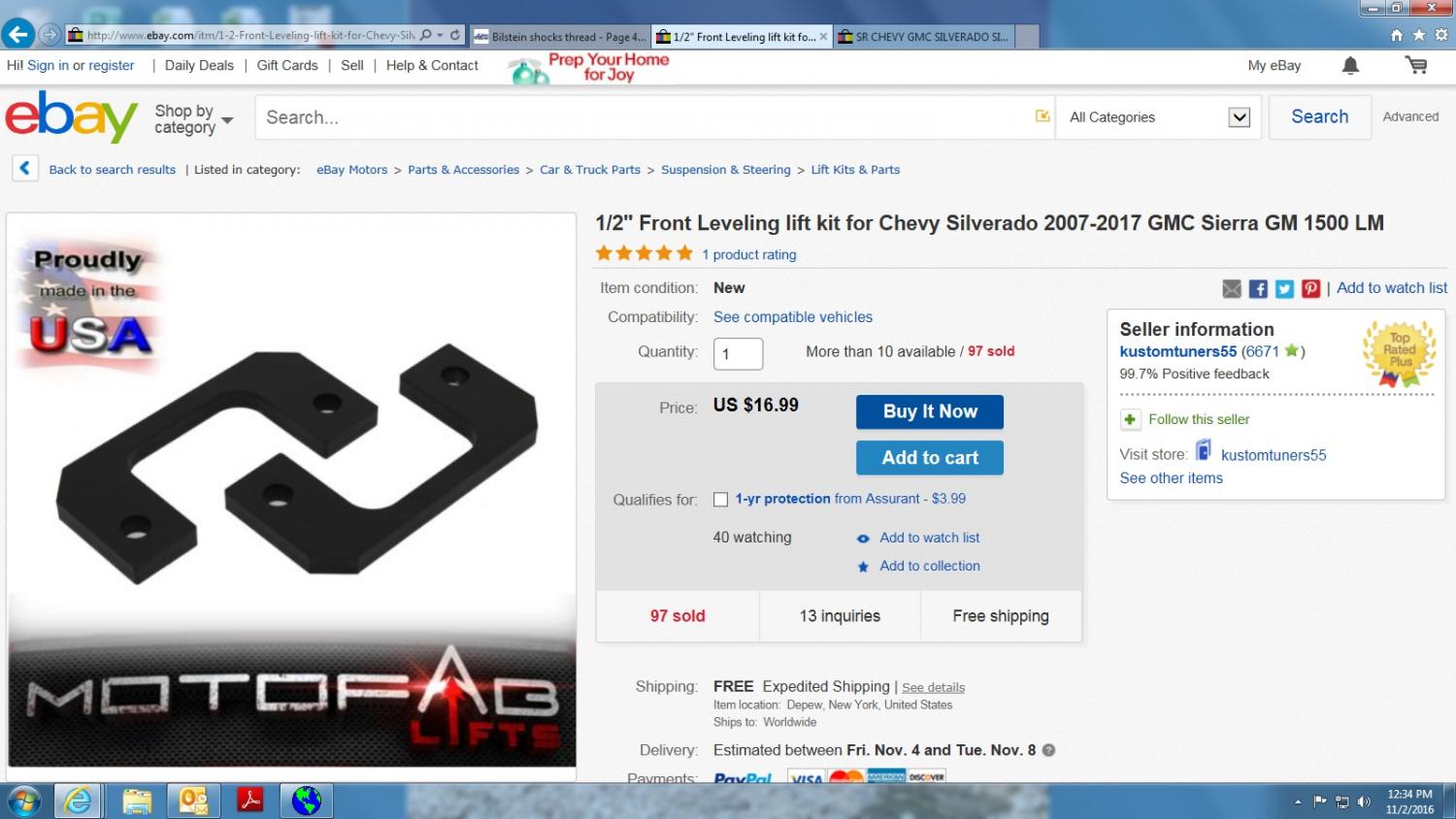

I wouldn't do that, the B5100's are designed to give you more travel out of the strut than with a regular spacer type kit. I would just add a 1/2 rough country type spacer under the lower shock mount to give that extra 1". I have the B's on my 15 and still have about a 1/2 rake. post-155210-0-11797700-1478115362_thumb.jpg or go with RC 3.5"

I wouldn't do that, the B5100's are designed to give you more travel out of the strut than with a regular spacer type kit. I would just add a 1/2 rough country type spacer under the lower shock mount to give that extra 1". I have the B's on my 15 and still have about a 1/2 rake. attachicon.giflevel kit.jpg or go with RC 3.5"
I really dont want to add the .5" spacer. Im enjoying the ride quality I have now which is why I was considering putting the Bilsteins on at the lowest setting, rather than getting bilsteins and having to set them on the highest setting.
