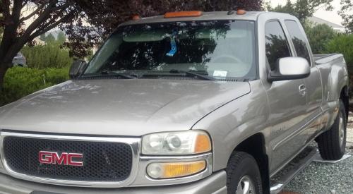

Also, is that the truck in your picture above? Looks nice. However, that is a 1500 series truck, not a 2500.

Yes that is the truck in the picture... Hint new to me truck lol ok 1500 cool now we know what we have :)
