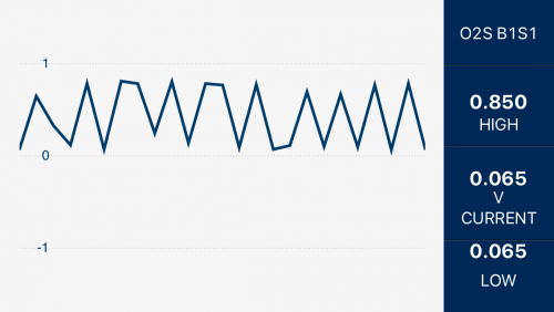

I have a 2004 Silverado, 5.3 liter gas only, with problems, It began with Knock Sensors low voltage. Both were replaced. No luck! I replaced the knock sensor harness, no luck. My reader still shows lo voltage on sensors bank 1 & 2. I had a suggestion to replace the O2 sensors. Even though it's not showing on the code reader, i was told to change them. On my reader, I have a live data view and Banks 1 & 2, upstream Sensor are reading all over the place. It's almost a saw tooth pattern. Is this normal?
At idle, it misses randomly. At full throttle, it bucks pretty bad. Anywhere in between, its good. I'm an old carburetor and points man, so this new fangled technology is leaving me scratching my head!
I attached the readings. Please HELP!
That looks normal to me for a pre-cat sensor. If it's switching, it's good. Lingering high or low (lazy switching) indicates a bad sensor.
